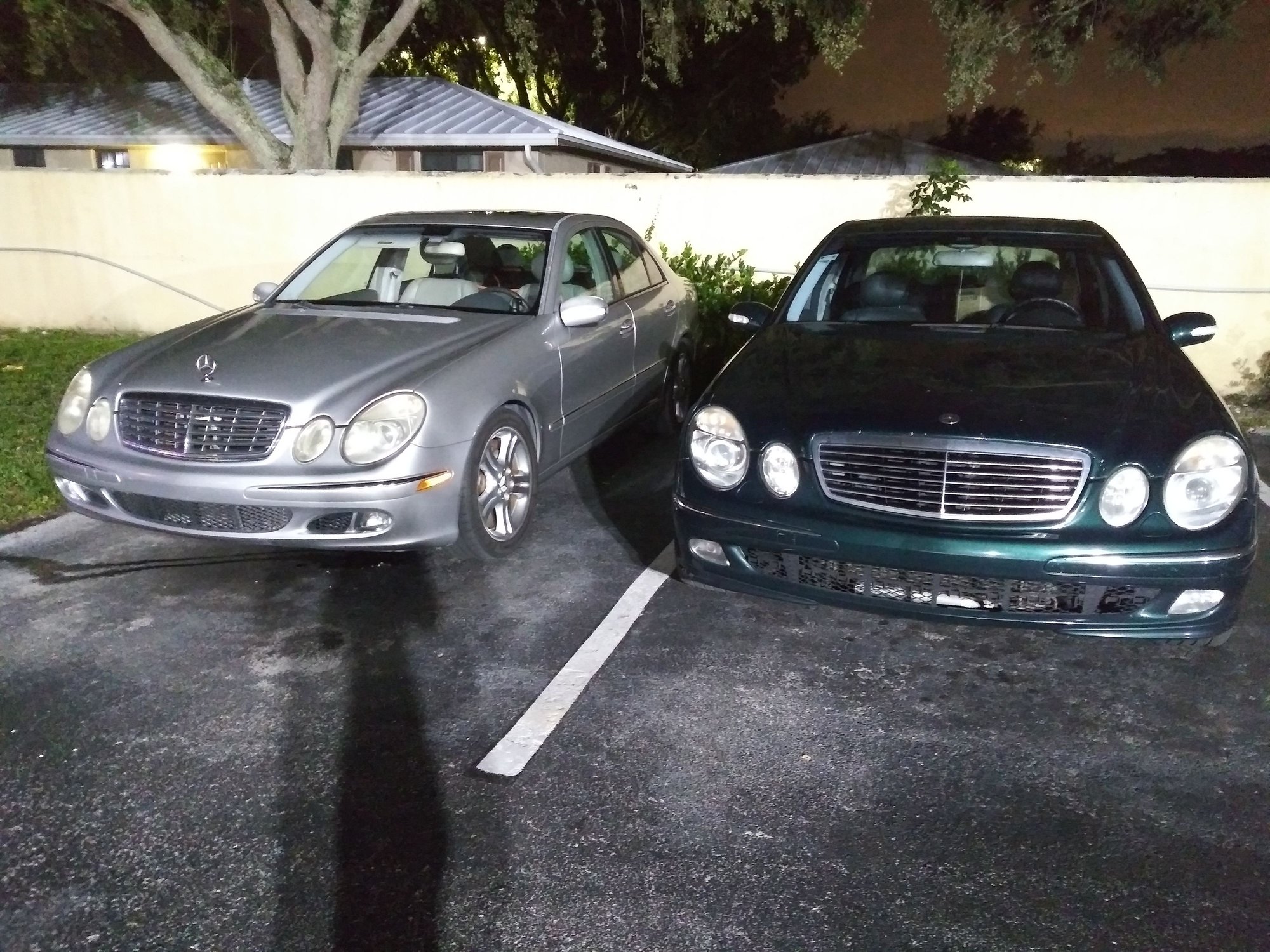

My E500 is the silver one, my dad's was already converted at all 4 corners prior to him purchasing it. I've always envied how connected I felt when driving his car, a feeling my car doesn't have. Even in sport 2 it feels detached from the road to me.
