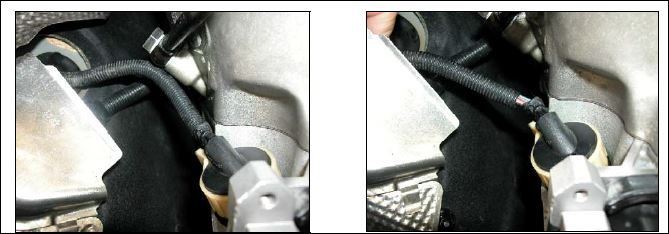

​​​​​​Where is this connector located?

https://www.mercedesmedic.com/722-6-...sion-plug-diy/
