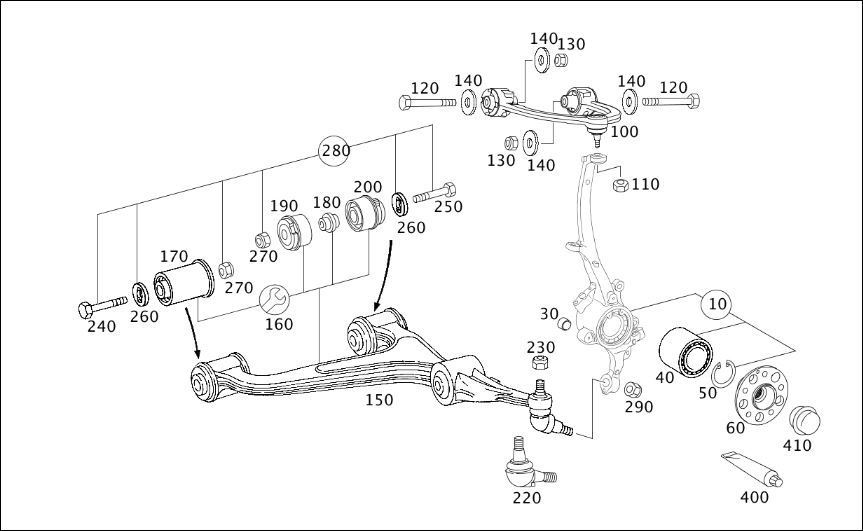

So as far as I can tell the speed sensor ring is part of the hub and isn’t serviceable. Does anyone know the part number or can send me a link for the right part. I’ve looked around and can’t find a front hub for a 4matic or can tell if the ring is on it or not
Old Jan 19, 2022 | 04:52 PM
konigstiger's Avatar
Posts: 15,901
Likes: 4,632
From: North Scottsdale, AZ
'71 Pinto
See attachment.
