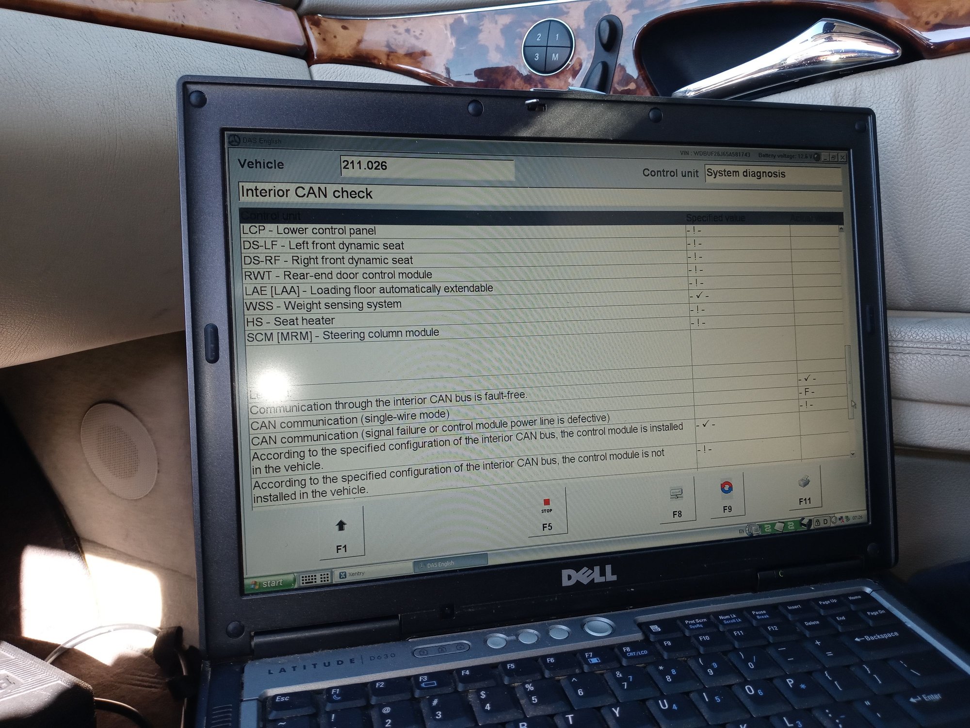

Scanned & thoroughly interrogated ALL control units indicating any variant of "F" or "i" in DAS today & there would appear to be no shortage of DTCs this time so after carefully documenting each I erased them all to see what would come back.
This scan took alot longer (approximately 15 minutes) than it would have if canbus in car was working properly imho & based on what it came up with in the end, would seem to have timed-out w/o establishing comms w/ anything which I found to be very interesting but confusing.
Current CAN configuration in L column but "actual values' in R column. It's reporting everything as 'NOT PRESENT' but all accessories are functioning properly so very peculiar & unsure what really can be done here. Does anything need to be done? Could this situation be causing ESP & other control units to crash suddenly? That's what I really want to try & find out so can restore some faith in this car's reliability to safely commute 330 miles per week.
...More control units being reported as "NOT PRESENT' (sorry about flash glare! Sun was moving around behind me.)
The vehicle starts right up & runs smooth without hesitation or errors. Individually, I'm able to interrogate each control unit so CANBUS is working to some degree & all accessories are functioning flawlessly as well. I'm unsure how to really tackle what is being displayed. I will pull & check all fuses & relays next to see if any are cracked or blown.
