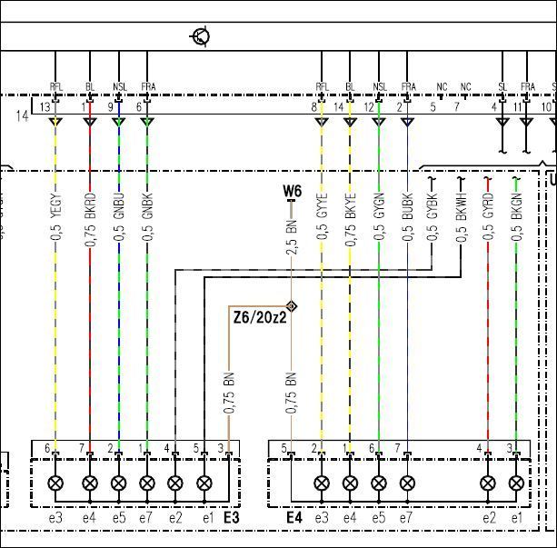

06 E500 WAGON REAR LIGHTS DONT WORK
I replaced all four rear light panels and I changed the brake light switch under the dashboard. No fuses are blown and my brake lights do not seem to work. The light bar on top of the wagon door lights up but no other lights in back work. Front lights are all fine. Who has any answers that can help me here? Thanks.

Pull rear SAM and check connector 14 including pins. All fine possible SAM malfunction.
