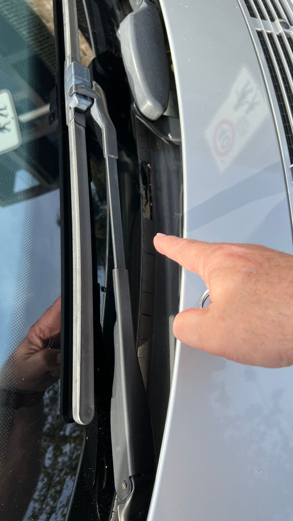

Hi thanks to any one who can help here. Please see picture attached. The rubber directly under the windscreen exterior is perished. I'm trying to find this part number as I believe it is actually part of the windscreen wiper unit. Can you buy this rubber strip separately or do I have to buy the whole shebang? Any tips/supply recommendations are most appreciated

Replacement new shop current part # 2118301213, used 2118300013. Attempt repair: https://www.benzworld.org/threads/re...#post-18150071
