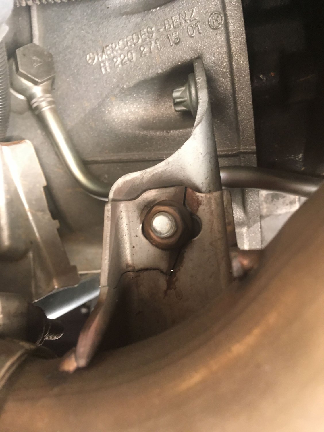

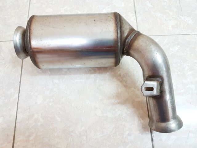

clvincent were you able to identify the rattle/vibration? I had a similar issue on my 06 E320 (about 215,000 miles at the time) and found the tab on the catalytic converter assembly had sheared... attached image shows tab location (unbroken). On mine the broken half of the tab was still in place, with the bolt holding the two halves together over the crack. This was causing vibrations at low rpms on acceleration and in the situations you described. My solution was to add a washer under the bolt to apply more pressure across the sheared area to hold the two halves tightly together. This has alleviated the vibration for about about 15,000 miles now. Hope this is useful and your issue wasn't more serious.

Also I found a picture of the cracked bracket I referenced in my previous post. Hopefully this helps anyone with the same issue, as it took me quite some time to identify this as the source of the vibration/rattle.

DOEDLI:
Yikes! I’ll look at that bracket more closely on my 2005 CDI. Where exactly is that? It looks like the transmission bell housing. Of course, once I’m under the car, it will probably be easy to figure out as the catalytic converter is pretty specifically located.

This should give you a good idea where to look (not my photo). The wheel you see at the bottom left is the front passenger. A bracket links the transmission housing to the tab on the catalytic converter, as seen in the center of the photo.
