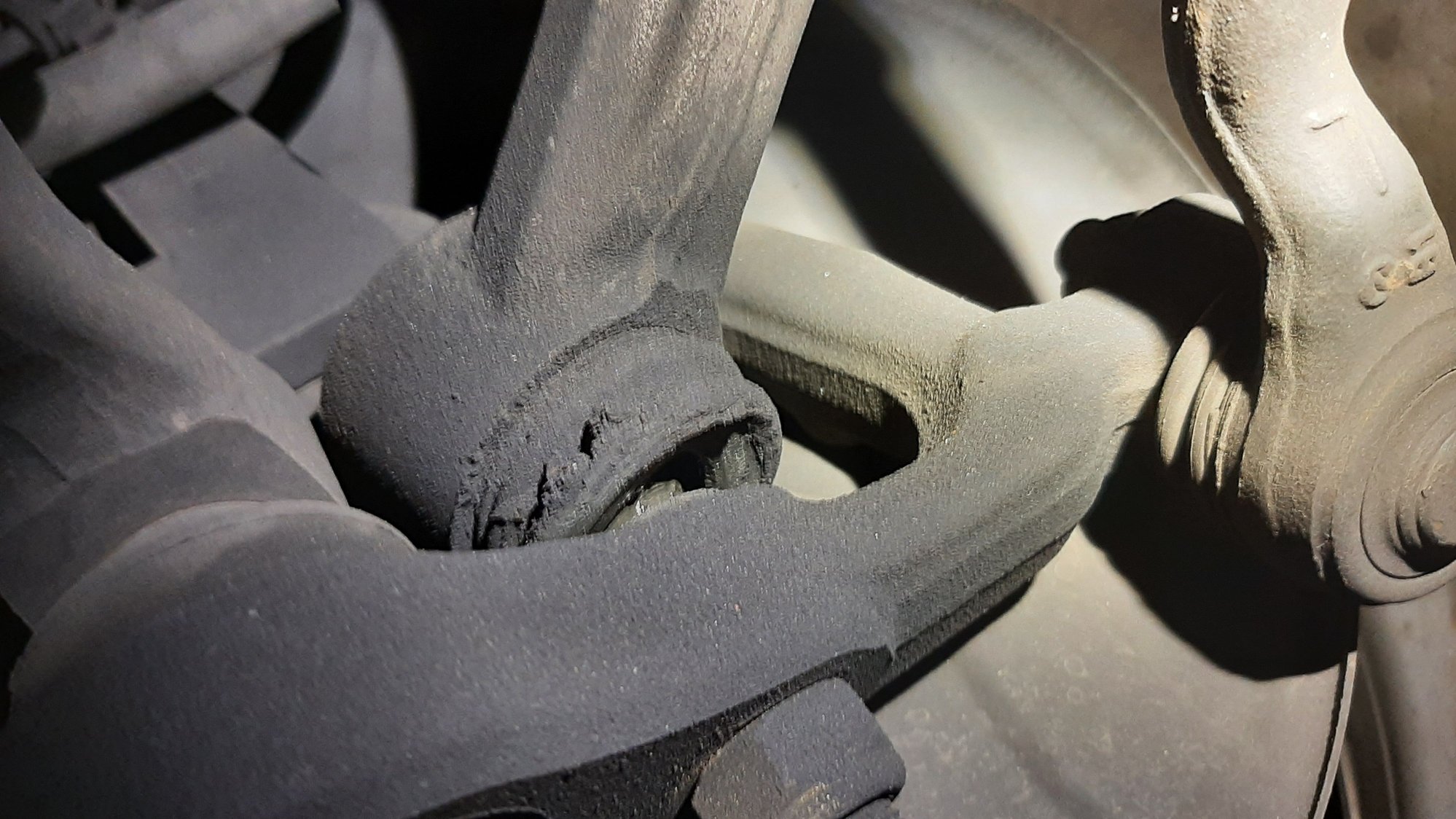

Chasing a terrible noise. Replaced this arm which obviously failed and no change. The other lower ball joint?

It’s almost certainly the lower ball joint. Common problem on W211. You can test by injecting moly lubricant with needle into the rubber boot. Noise should go away temporarily. Ball joint is pressed in. You’ll need tools if you don’t have them. Don’t buy OEM ball joints. Lemfoerder (ZF) aftermarket ball joints are better and far less expensive.
