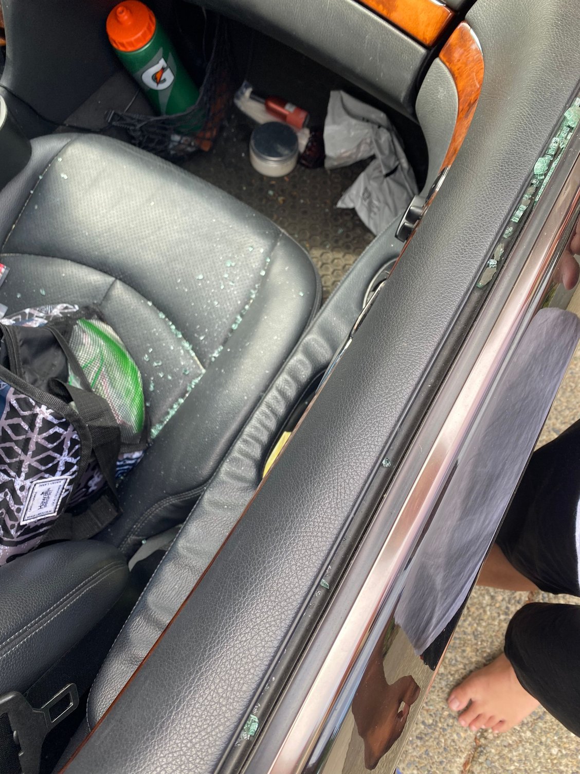

How do I remove and replace a front passenger side window?
Low life broke my passenger front window to steal my backpack. I bought a used window. I did a search and can’t find any tutorials on how to replace this. Can someone point me in the right direction? Is this something I should just take to a mechanic to do?
