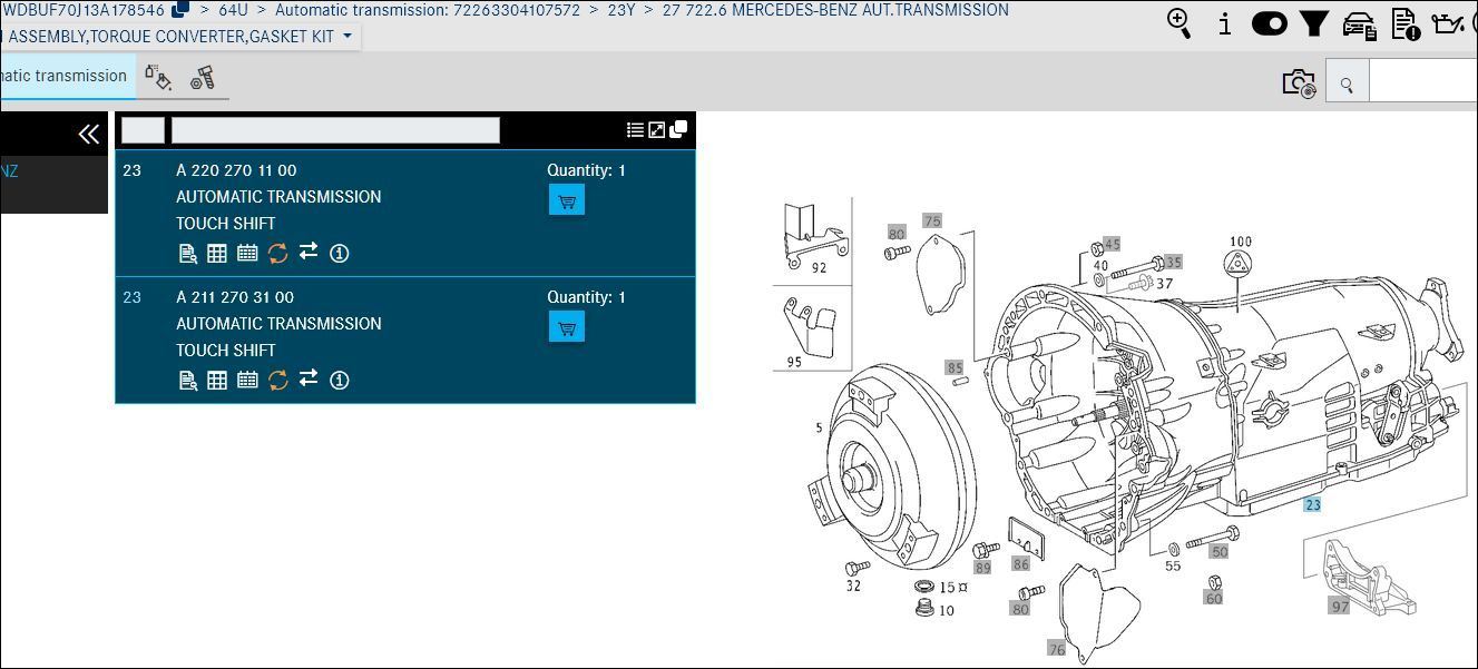

Hey guys, I have an 03 E500 with the 722.633 trans. Long story short, she needs a new one. My question is, what cars(if any) can I use a tranny from? I.e any car with a 722.633? Any info helps please, and if theirs a thread with info please share. Thank you for you time.

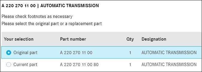

Shop part # 2202701100 and 2112702100.

So, S, SL, CL 500 rwds will work?

Revised capture either part # is compatible.

would you like my vin to put into your system? Would that give you my cars options for replacement?

Same as previously posted.
