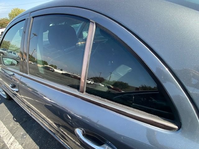

Dear MBenz W11 E350 Forum,
The rubber window weatherstripping on my 2006 E350 is cracking and looks horrible. Any help on guidance on replacing these would be greatly appreciated.
Thank you

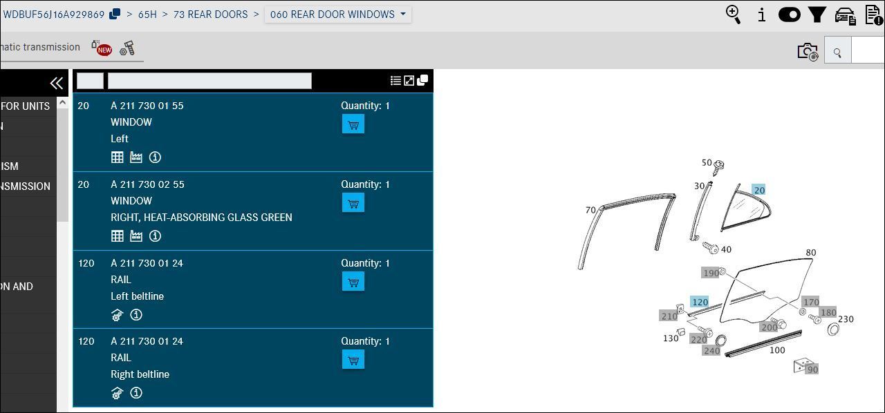

Seal is not available separately fixed window needs replacement, see attachments. Part # confirmation, provide VIN.

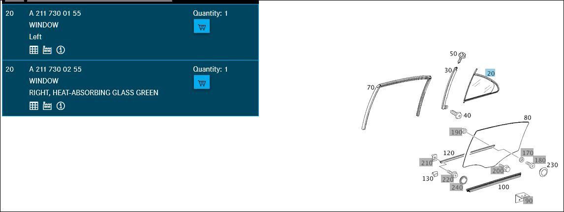

Hi! My VIN is WDBUF56J16A929869 (2006 Mercedes Benz E350). Is it part #120 or 20 which I need to buy? Are these easy to replace or need to go to the dealer? Thanks

120 is lower seal to power window, 20 is complete fixed window.
