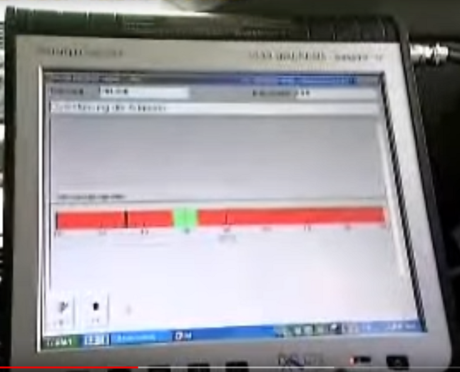

Ive read about the TCC adaption process and also seen a few videos where they go through the procedure with DAS and relearn the TCU to the new converter and so i thought i could do this myself being a proud owner of a StarC3 system.
Well for some reason there is no Adaption procedure for the TCC, there's only the information page or procedure description page that can be skipped with F2 like in any other procedure in DAS but there is no option to hit F3 to actually start the adaptation.
Ive searched the internet for days and also visited the dealer to ask but they were all pretty sure there is a adaption procedure for these cars.
I could only find one long thread where someone also mentioned they could only see that info page but he wasnt the OP and sadly his question didnt get any comments.
I will add some photos of the options i have in the TCC adaption section and what they do.
Ive tried it a few times now as i wasnt sure the temps were cold enough as i had the engine running the first time but no matter what i do there is never an option to hit F3.
For instance in the gear shift adaptation menu the F3 button will only pop up if the trans temp is 60C or higher so im guessing its something like this as well for the TCC adaption.
For the TCC it wants temps below 20C which i definitely had everytime ive tried to do this procedure, ive tried P and N, ive tried starting the car while i was in the menu and ive even tried to have a friend sit in the back like MB recommends lol. yeah maybe the engineers tied in the detection sensors in the seats for this idk.
Really hoping some trans gurus on these forums know about the procedures and can tell me if there really is something missing in the software and if maybe something else could cause this after only swapping the TC?.

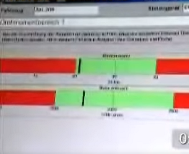

This is what i expect to see when the adaptation starts:
