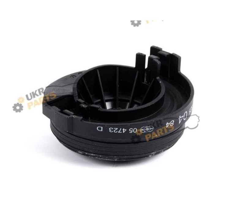

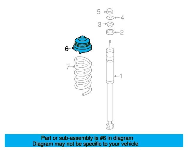

The rear coil comes with symmetrical shims on top. This can be 3 different sizes. Avantgarde being the smallest depth.
A211325058464 23mm
A211325
048464 15-19mm
A211325038464 9-12mm (
depending on where you look)

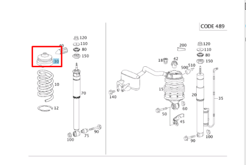

You need a left side and a right side of the fron Spring shims (or coil shims). Or do you?
This is what I've found so far;

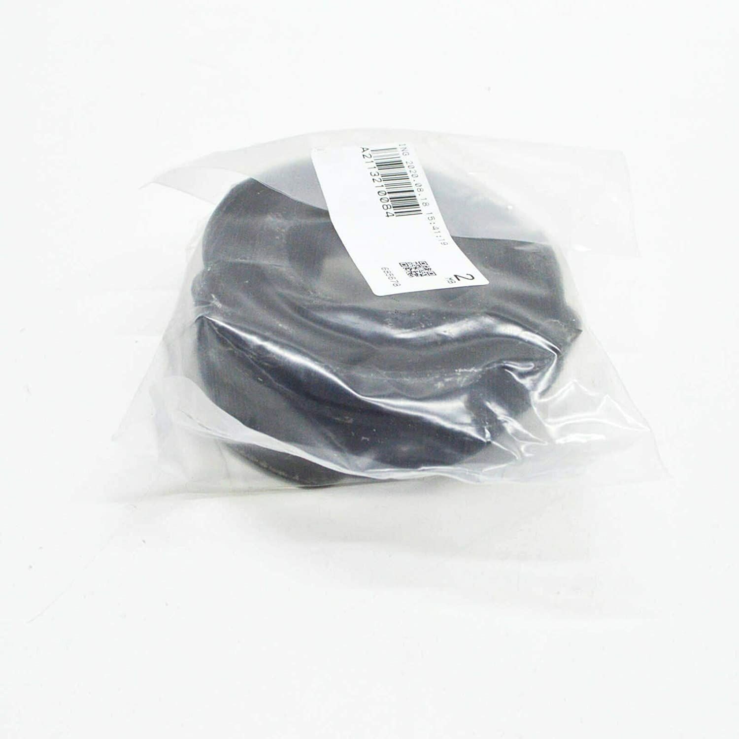

A2113210284 -not sure no sizes
A2113210184 - not sure no sizes
A2113210084 - this is what you get if you order from MB. But this is avantgarde. The slimmest. This will lower your car.
