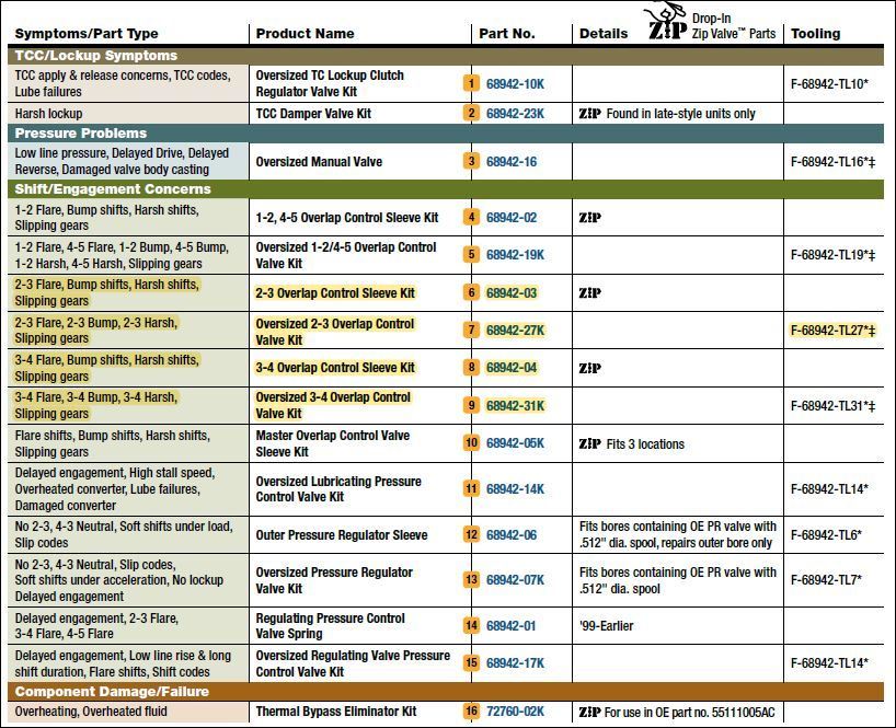

Given forum history: https://www.sonnax.com/valve_body_layouts - mercedes > 722.6
do you think overlap control valve kit would help?

Sonnax is a bit pricey, next step service or replace conductor plate & solenoids.
