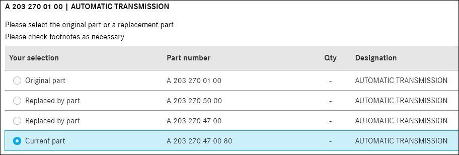

If you want post VIN I'll pull part # to shop.

Heres my VIN: WDB2110071B382188

Compatible part #s:
File Type: pdf
File Type: pdf
