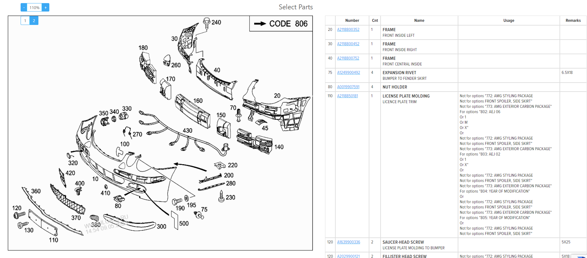

I own a 2008 S211 E350 and wish to convert my original bumper(the black one) to the AMG sport bumper (white one).
Other than the bumper cover its self, the grill meshes, fog lights and paint, what other parts would I need to order?
They guy at the dealer sent me this diagram for me to pick out which parts I need as they don't sell the bumper with everything included.
I plan on getting the parts straight from the dealer as i can't find any used here in Australia.

You need the VIN number, and access to the MB parts catalog. Based on the VIN, you get the vehicle's datacard and check which code you have for the styling, either 806. It would be great if you know the code for the AMG styling, I assume 807 since the dealer provided you with that snapshot.
Then, using your VIN and the parts catalog you can see which parts you already have, and which ones you are missing.

The numbers in the diagram(the one I posted) are they the part numbers for each part?
Thanks for the help.

Originally Posted by Tom pepicelli
Ok great.
Unfortunately, they are not. Those are numbers to point to the parts number table, see here
With the parts numbers, you can search online and get an idea of the price for each part and find out if they are still in production, or discontinued.

I've used this to look for random part numbers: https://nemigaparts.com/cat_spares/epc/mercedes/
Choose car, model, sub-model, and look for group 88 for attachment parts. From there you'll find that parts diagram on your #1 post, and scroll down for part numbers.

Thank you for that one.. Unfortunately, it does not pick the VIN for the datacard, nor the catalog directly (3 different ones) .
Looking for another EPC catalog, I also came across the following https://webautocats.com/epc/mercedes/1/fg/211056/65H/ and it works for the datacard, and the catalog. Very similar interface as your proposal, but it work better for me.
