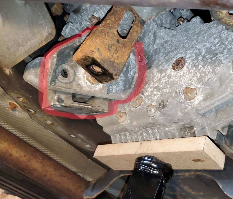

yes it’s really quite a procedure to drain the .6L of fluid. I even had to remove my trans rubber mount that sits just over the rear trans support member that also had to be removed. The rubber rear trans mount was blocking the drain plug. Thankfully I shouldn’t have to do this again 🌅
*photo shows rear rubber trans mount & assembly in red. All had to be removed to access the drain plug.
