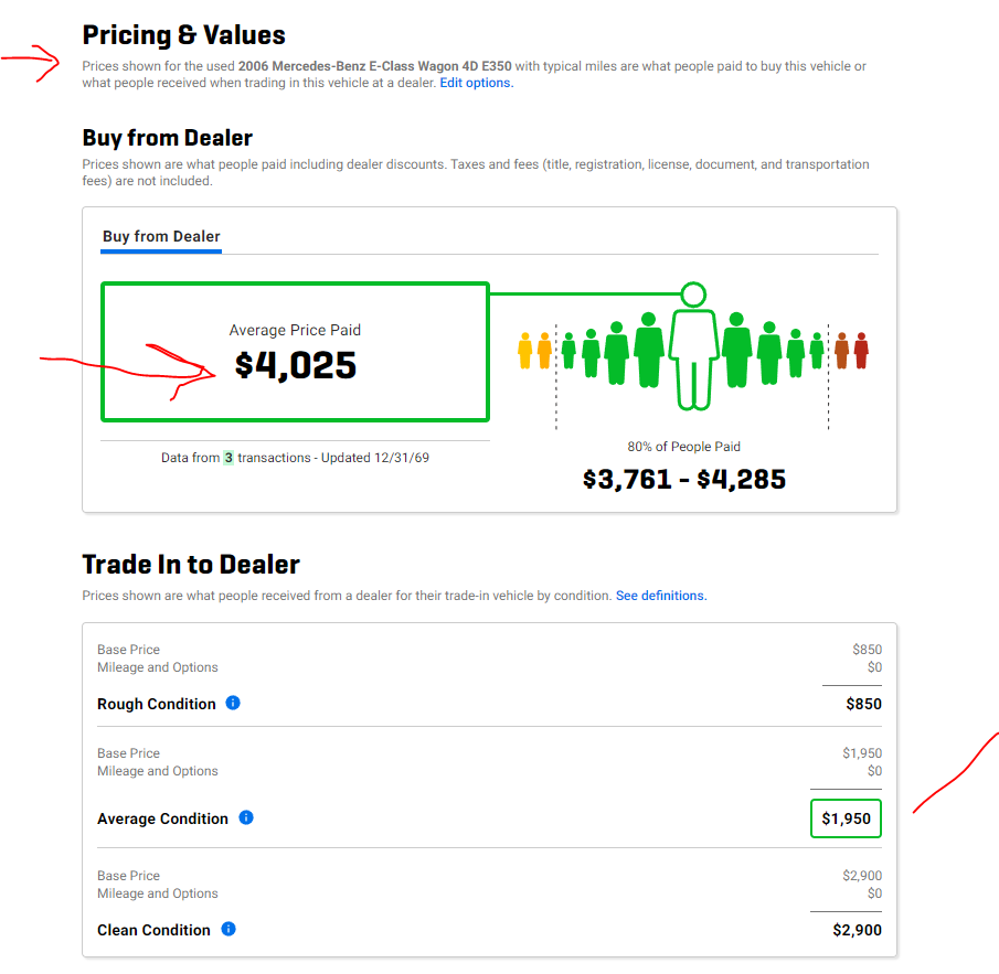

Price is very subjective, even more with used cars. The estimate of $1500 is not too far off the mark, see below
Here is a link showing the prices for used carshttps://www.jdpower.com/cars/2006/me.../wagon-4d-e350

Yeah I’ve checked the various sites to see what they were putting value at. Sadly they just don’t match the market. All of them put the wagons sub 5k. There just aren’t any out there in that price, and if there are they are junk. Wagons I see with rot that looks really bad I see ppl asking $3k for
