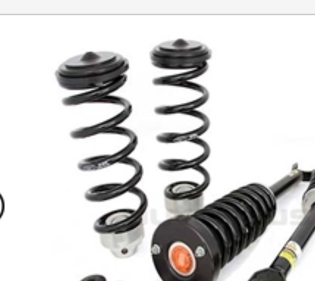

4MATIC air to coil conversion here. I went with Strutmasters and I love not worrying about air leaks, getting stranded on the street, and fearing that I would wake up to go to work and find my car slammed to the ground.

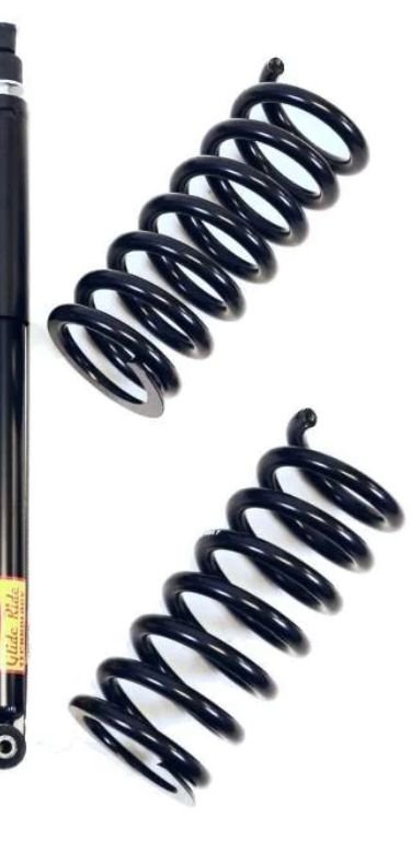

I chose Strutmasters because the rear coil count resembles OEM E350 rear coils. Arnott’s rear coils seem to look less durable and coil count is less than OEM spec.
So far, about 4 months in and the car behaves just like air ride without the weight.
i don’t know anything about suncore.
Strutmasters rear Coil
Arnott rear coil

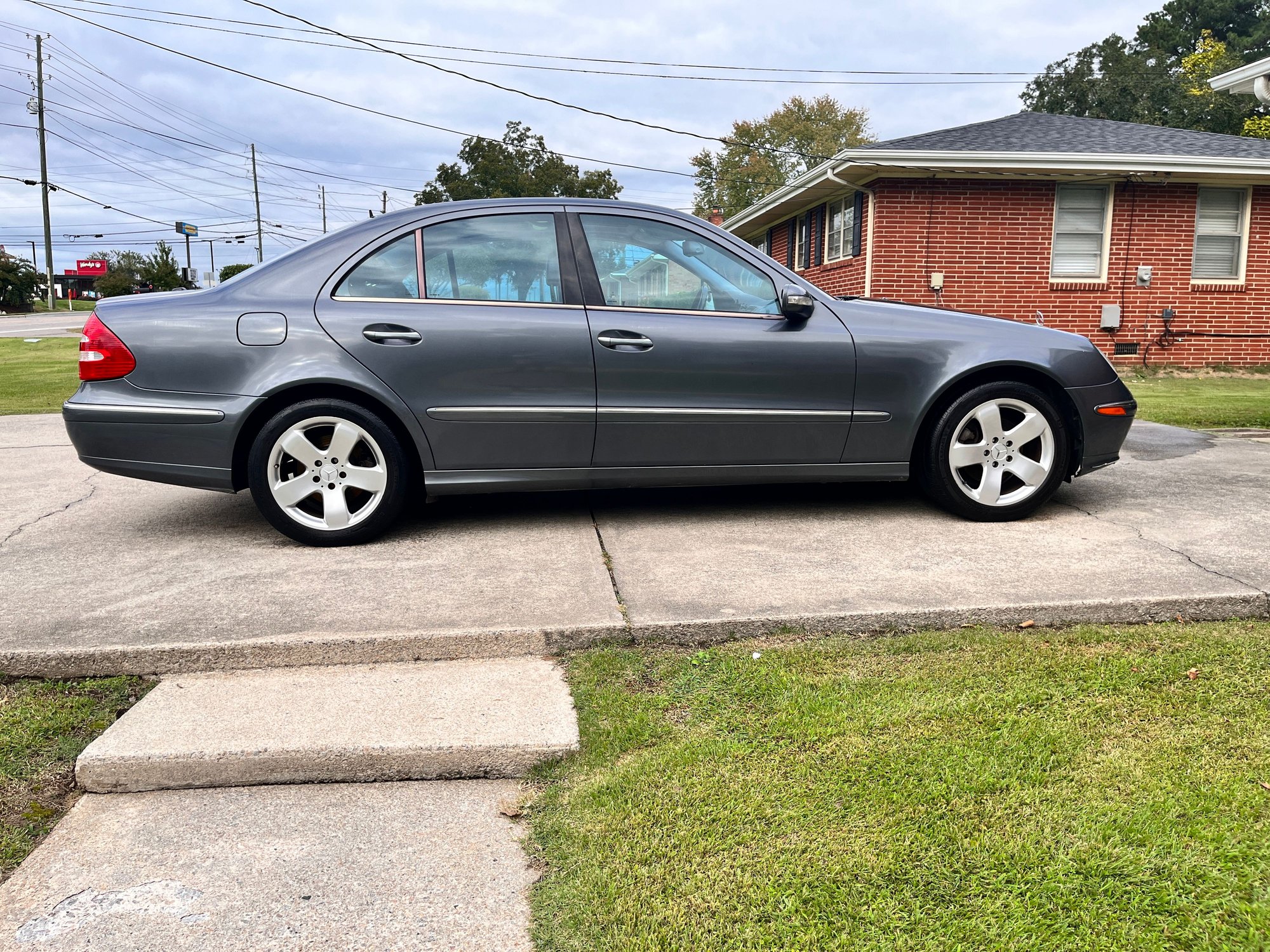

For anyone interested, I decided to go with Strutmasters kit ME14FM. The kit was $850 and the labor was $800 for a total of $1650. My mechanic said that it took 16 hours in total with the front being much easier than the back. Overall, I am very happy and honestly I think it rides better than air. Although I've only had the kit for a few days, I have found none of the bad things said about Strutmasters to be true. Photos below. I am a happy customer!
Before Strutmasters
After Strutmasters
