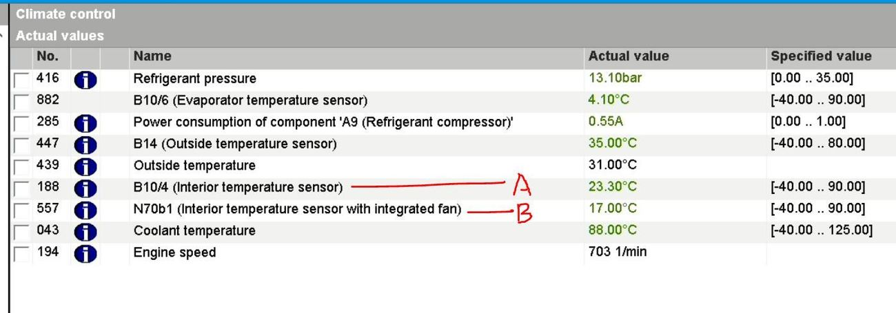

2- if you have an MB-aware scanner you can verify how much is the computer is requesting from the compressor, i.e. actuating the electronic control valve. These are variable displacement compressors controlled by the AC module at will based on other sensors around the car (inside and out).
Monitor something like this (from @S-Prihadi 's recent post)

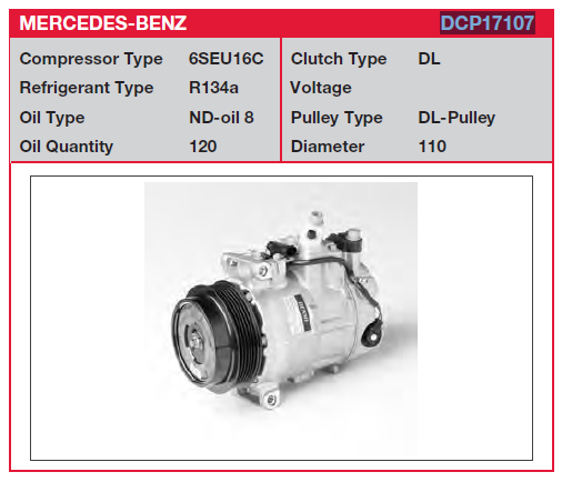

You need to check if there is voltage at the back of the compressor. For 2008, here are the compressors -> same for RWD and 4Matic
Can you see the yellow dot at the back? That is the Electronic Control Valve (with a DIode), you need to measure if there is power at the connector just on top. Either back probe, or disconnect and measure on the incoming wire.
