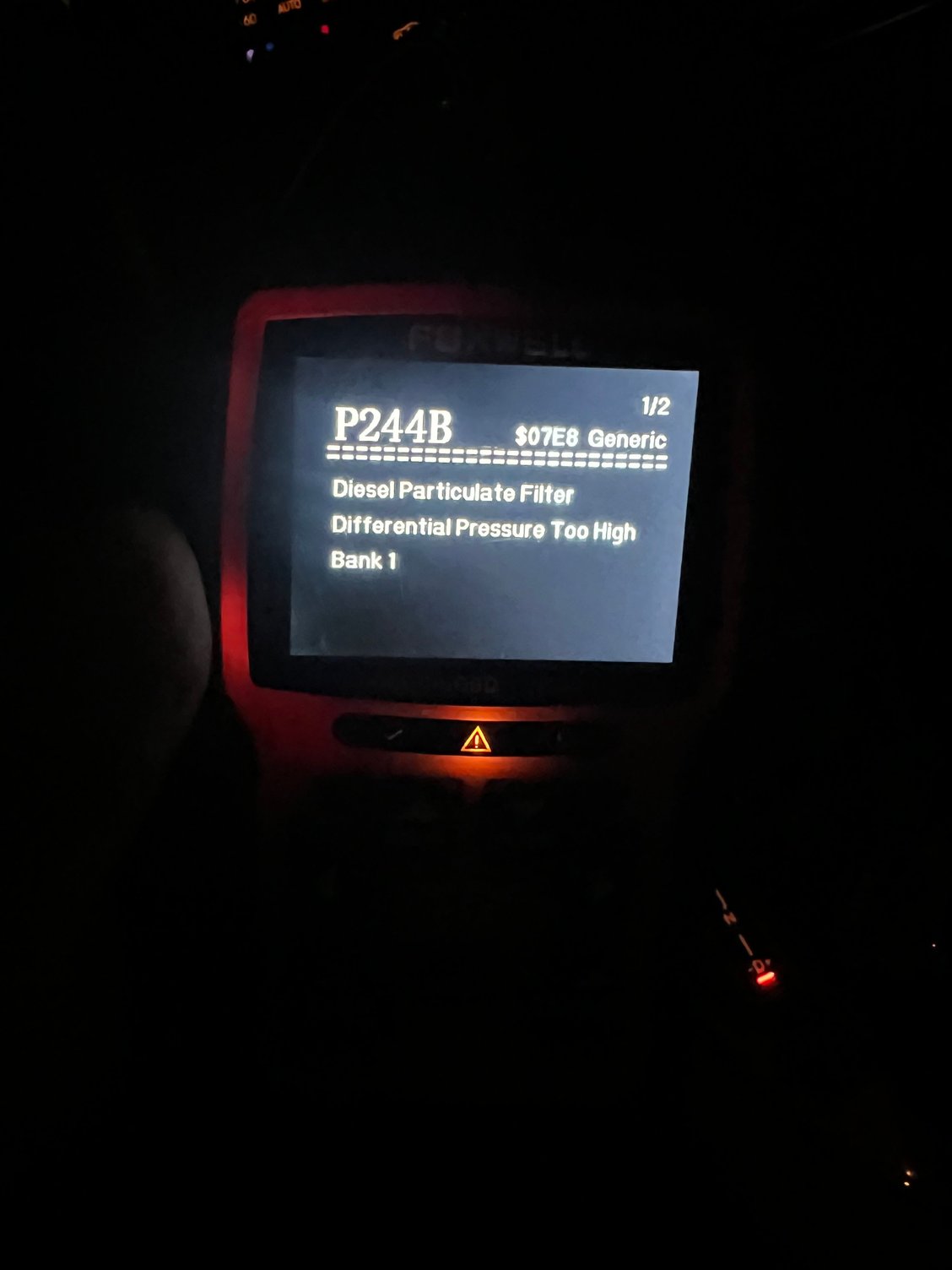

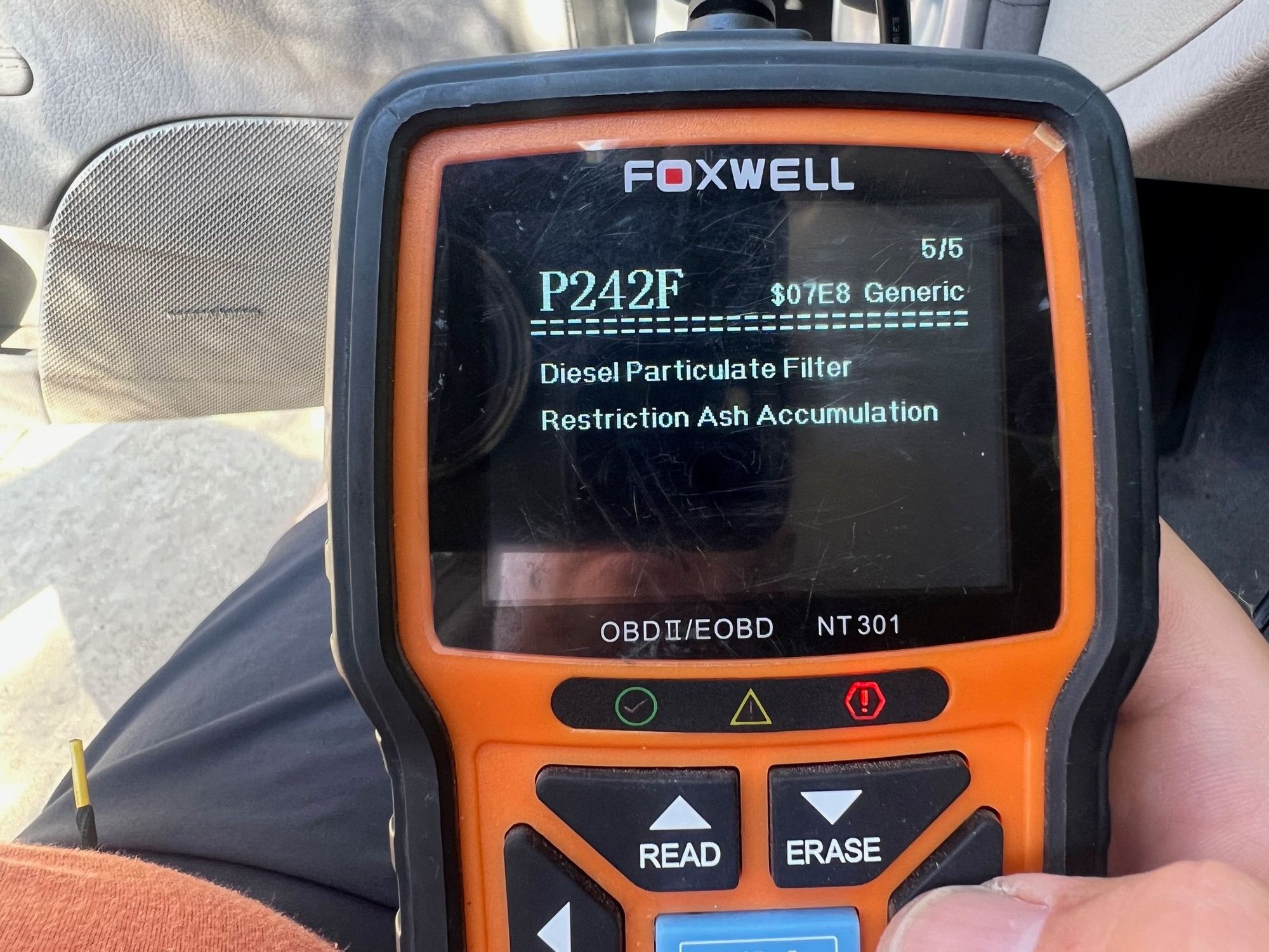

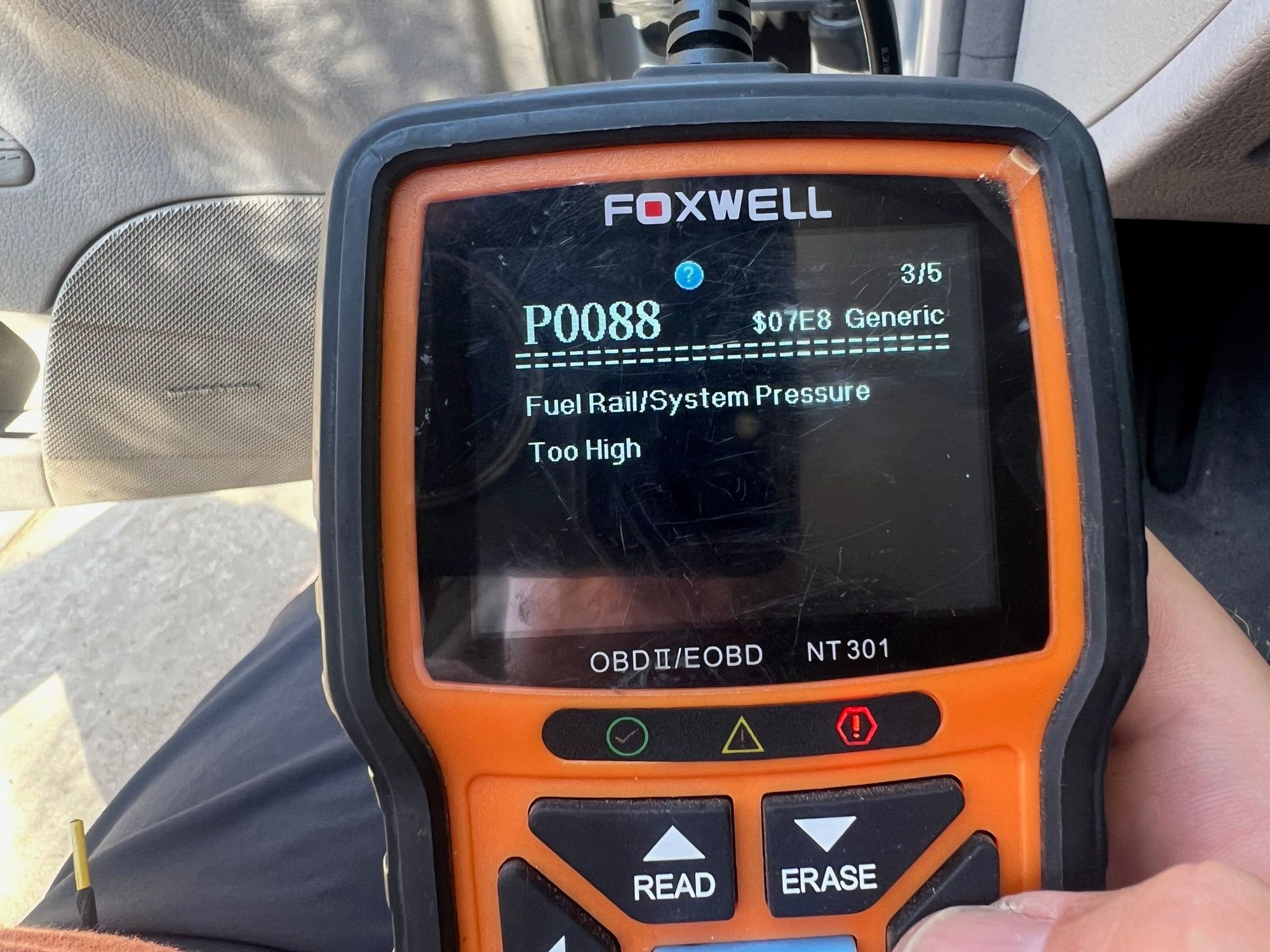

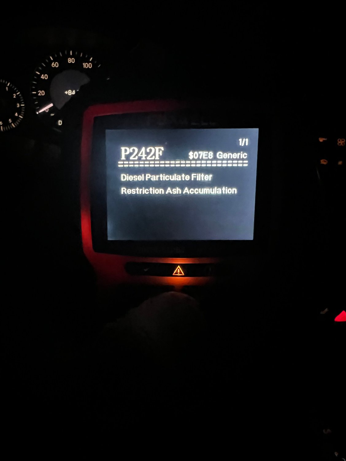

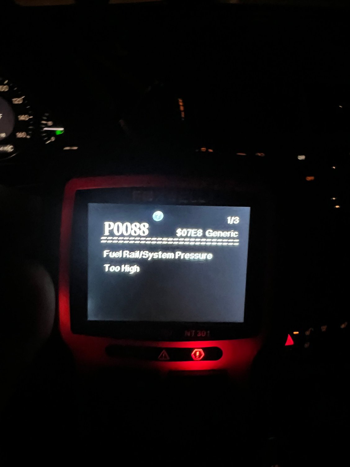

So I literally just deleted everything and when I started driving down the road, the first code that popped up was
P242F
After I drove about a mile
The code I got was
P2 44B
And then after about five minutes of driving, the code I got was
P0088
I’m going to post the pictures in order of the codes I received them in
Could it be just a completely ruined DPF?

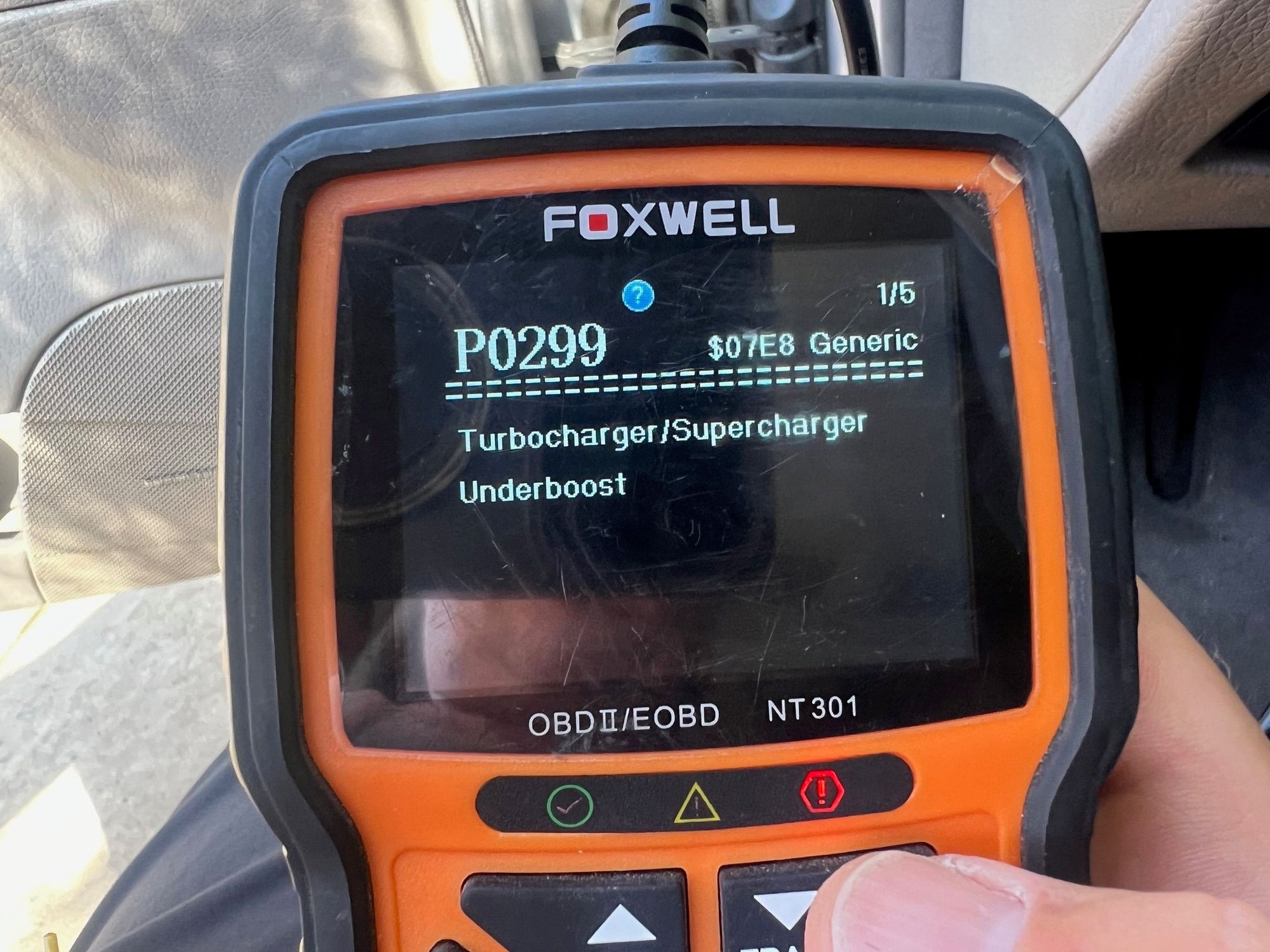

I deleted the codes again this morning after changing out the DPF sensor, and in this order the codes turn on
P242F
P244B
and then I believe it goes into limp mode with code P0299

You need to run a forced regeneration in to clear p242f. That's assuming you have a new or cleaned DPF.
