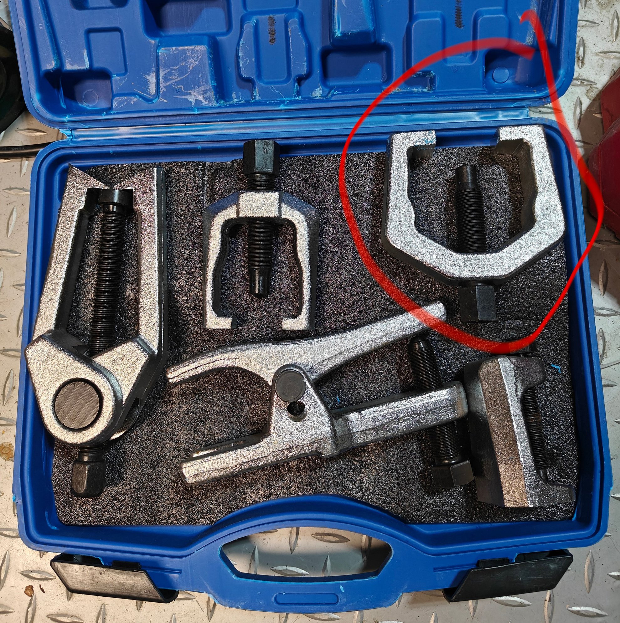

Got the orion kit. Will give it a shot tomorrow and pray that it works.

You’ll likely use the smaller puller to the left… not the circled one.
Sighh, unfortunately, it seems that the puller is too wide to get the control arm, unless I'm missing something. Maybe I bend it by accident.
you rotate it so one lip is under the arm and one is under the nipple/protrusion at the twelve o’clock position at the very end of the arm, other side of ball joint. In your pic, basically rotate yours about 90 degrees in the pic. I swear, once you figure it out, it will always be easy. Don’t try to “rig” your tool
