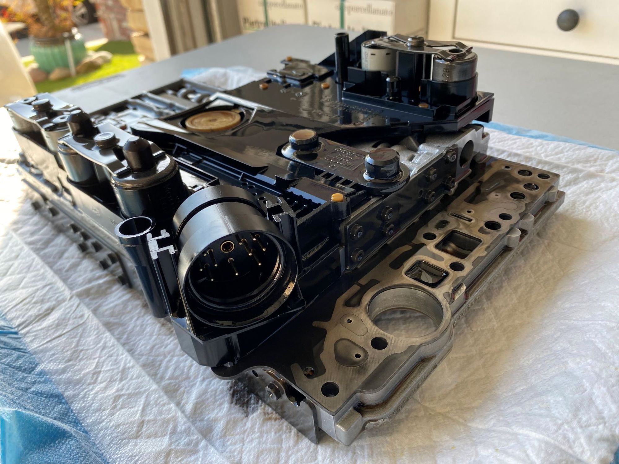

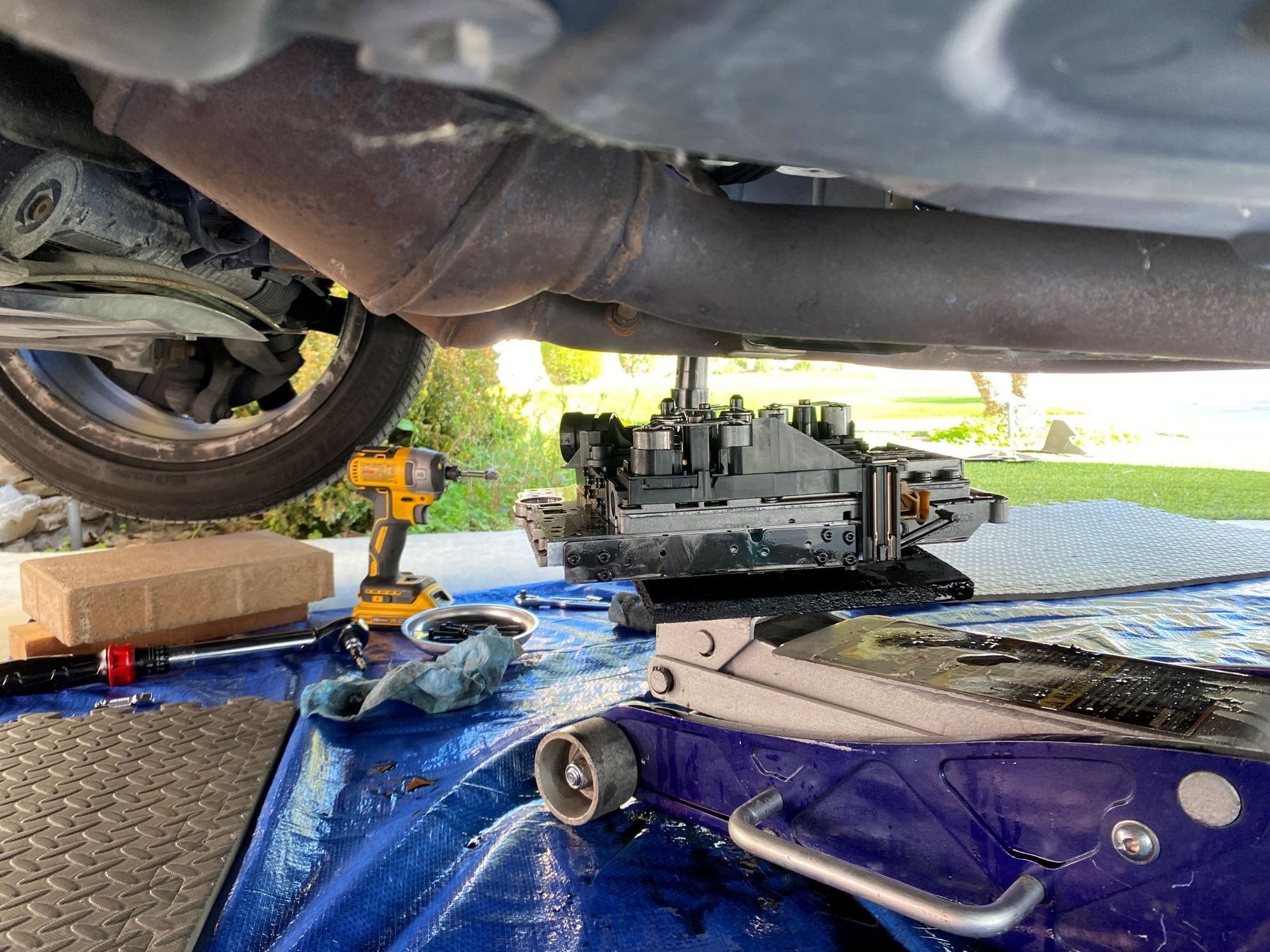

did this job over the weekend after gaining lots of confidence with all the resources here and on youtube DIYs. i bought the complete conductor plate service kit from FCPeuro. while it was not overly difficult, the job sure is messy! i'm glad i anticipated this and laid a trap down to catch (most) of the ATF.

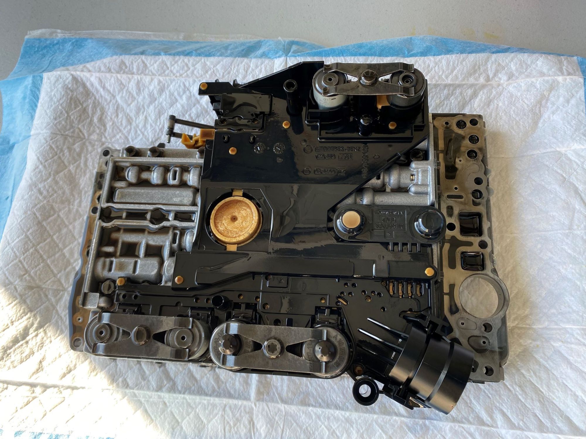

the conductor plate didn't look too bad and the speed sensor wasn't overly loose or decayed.
i did not find the 13-pin pilot bushing to be leaking at all, but it was replaced with a brand new unit included with the kit. the old o-ring is still on the original conductor plate.

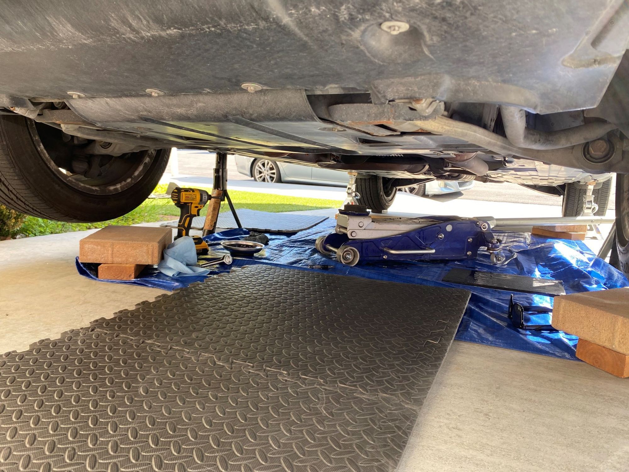

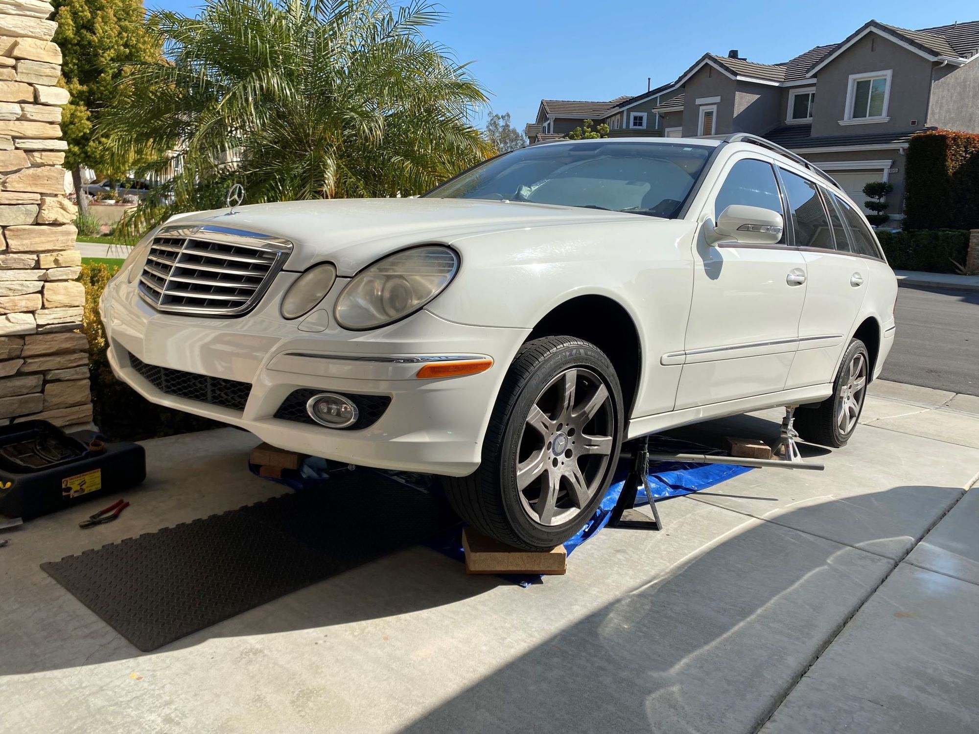

did this on the driveway after getting all four corners off the ground. a lift would have made life so much easier (always)!
since i was by myself i used my floor jack to support the valve body upon removal.

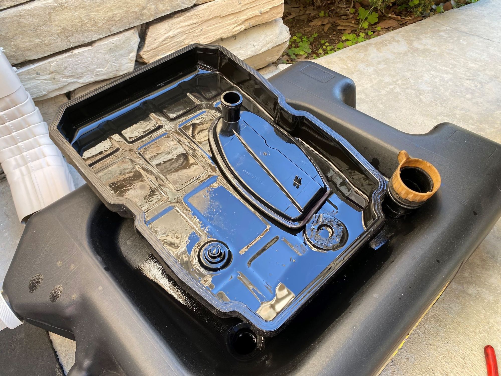

interestingly the filter just fell out when i removed the pan. lots of trans "debris" on the pan magnet!
going back in, i had to get the wife to work the jack while i reposition things. aligning the shifter detent took most of the time. so messy!
i ended up using all 5 quarts of ATF. i cleared the code using launch x341 creader elite (great scanner)! all in all the job was very straightforward and i'm glad to do it instead of paying a shop which quoted me 4 hours of labor (reasonable, since it took me 2x with cleanup).
