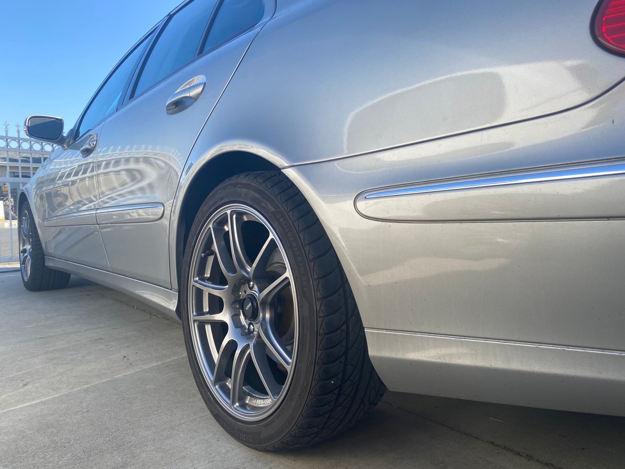

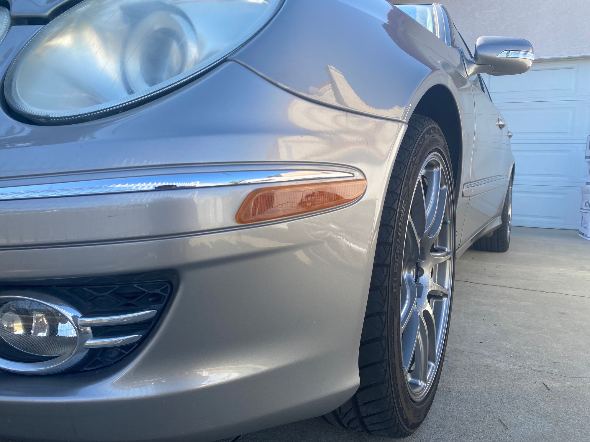

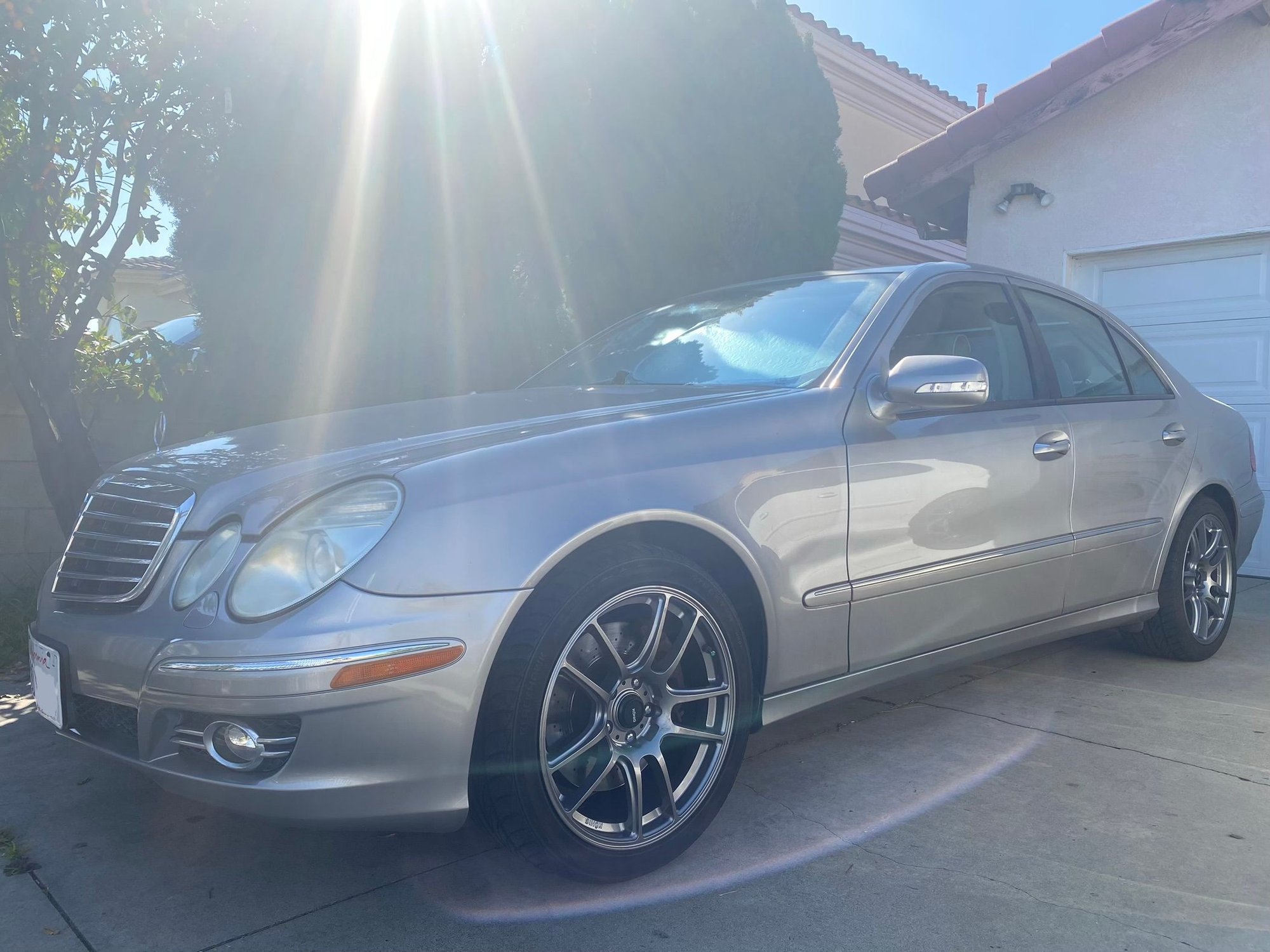

I found out one of my wheels was cracked and poorly repaired by the previous owner. Originally planned on replacing wheels with something from E63 AMGs but after some more research, I found they are very expensive, even used and worst of all, still heavy and cast. I always assumed incorrectly that they were forged or at least flow formed to be worthy of AMG but I guess not. Needless to say, I’m not paying a premium for used, heavy and cast wheels with a fancy badge so I searched the aftermarket options. Konig wheels were never previously on my radar but after comparing the options, these were the best I could come up with.
Not the style or brand I had in mind but I’m very happy with the decision and results. I wanted the same OEM size (18x8.5) with slightly more aggressive offset (32 vs OEM 38) and lighter (>19lbs vs OEM ~30lbs). Losing around 10lbs per corner is the greatest upgrade and very noticeable improvement in braking, handling, comfort and acceleration. I saw the OEM sport wheels listed at 25lbs but when I weighed mine, they all came in around 30lbs so that spec out there is wrong for whoever is interested. 28lbs if being generous based on possible scale and other discrepancies. Either way, glad to have those anchors off the car.
