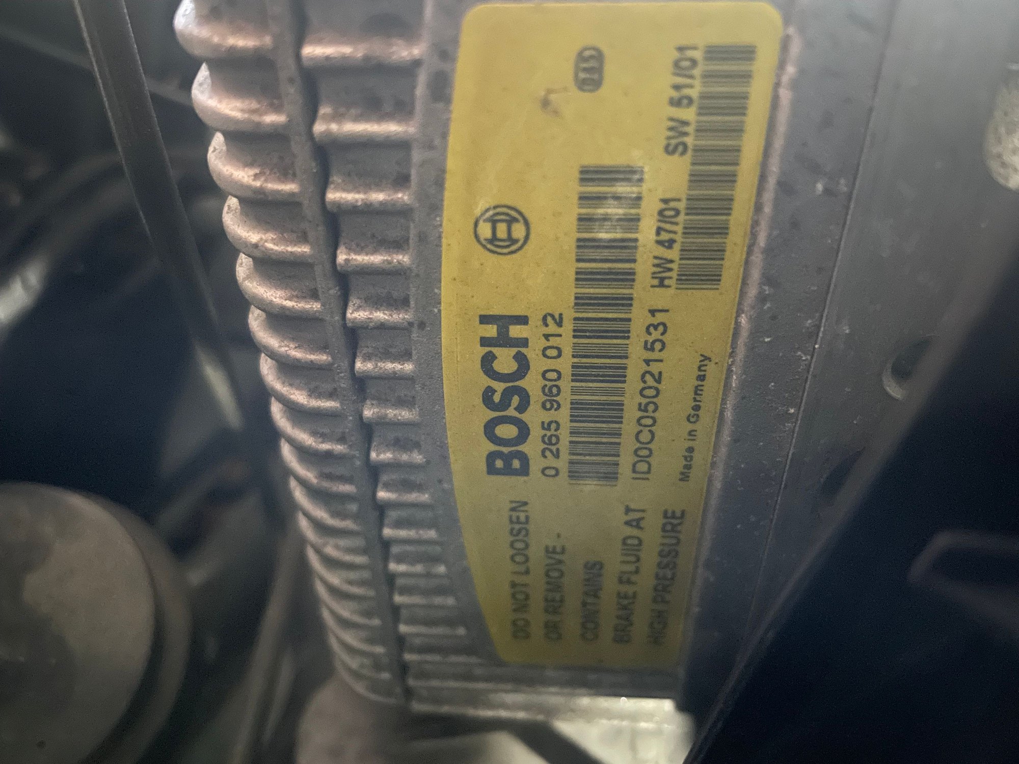

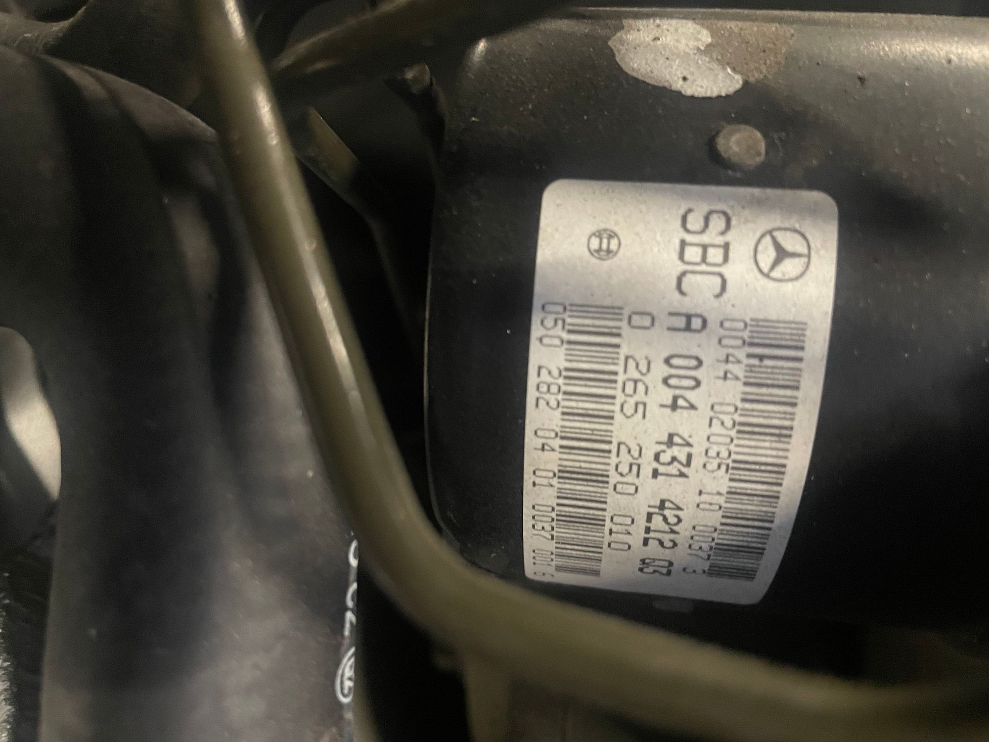

This is all the Numbers I Can find on my unit. What im preferrably looking for is if there is any other part Numbers that Are interchangable with my Sbc. Looking to buy a used and Get it to work quickly😀 Thank you so much for replying
ps the unit might have been replaced earlier by another owner. Thats maybe why the Numbers dont match with your catalogue
