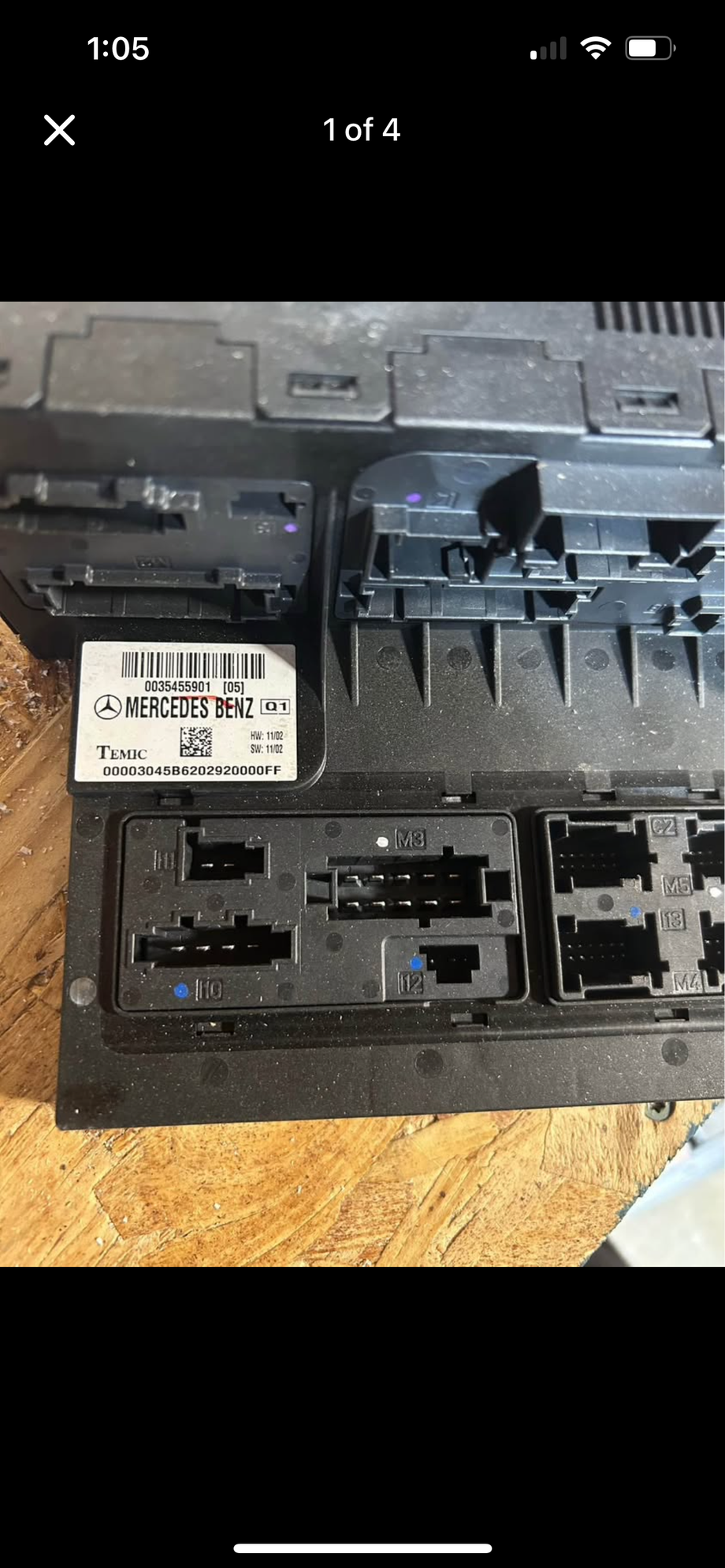

can see if this will work for your car. If so I got one. Pulled from a parts car (rear end rusted out wouldn’t pass inspection)
$80 plus shipping
you can swap parts from other models but it needs programming
