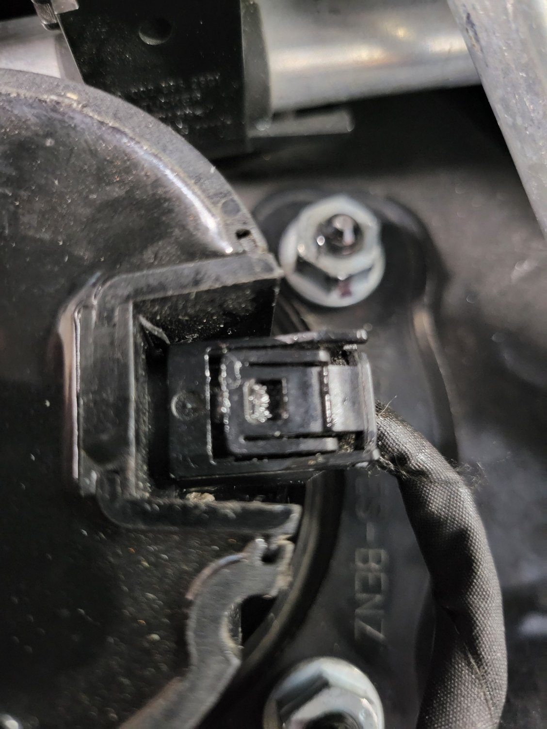

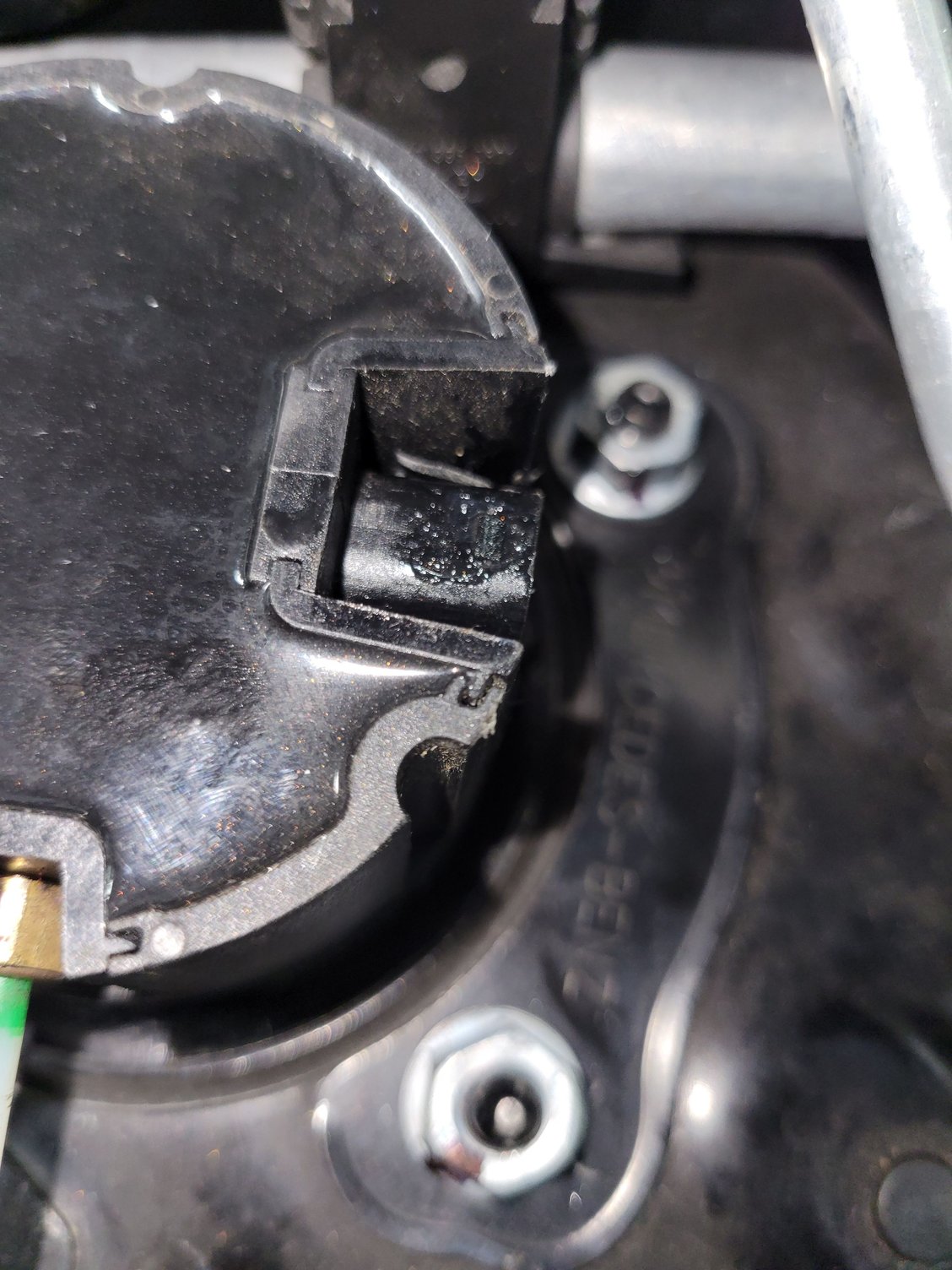

One thing I did notice is that the harness plug going into the strut hat isn't fully secured. The locking tab on the harness plug doesn't fully seat.
Almost like the shroud covering the contacts on the strut hat is slightly to long not allowing the harness plug to fully seat.
Tried a little die electric greese around the shroud but still won't fully seat. Might try and shave a little off the housing, see if that works
