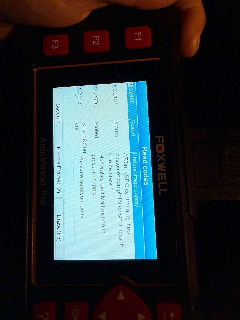

Pulled these codes. Does this mean my sbc is failing and should be covered under the recall?

According to SBC Extended Warranty USA, yes pressure reservoir is covered in USA.

It's not a recall, it's an extended 25 year warranty in the US. So yes, you'd be covered under the extended warranty. There was no recall on the SBC.

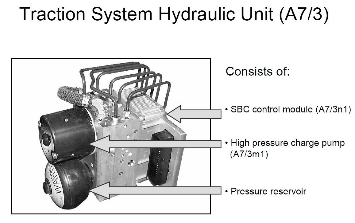

Hi, I am getting the C2131 'pressure reservoir faulty' error on scanner and I get a 'service brake visit workshop' in dash. Can I just change pressure reservoir without changing the whole unit? Thanks
Old Today | 07:32 PM
bbirdwell's Avatar
Veteran: Army
Joined: Jan 2014
Posts: 3,978
Likes: 1,322
From: Republic of Texas
'99 and '05 E55 AMG
Must use Xentry or aftermarket equivalent to disable the SBC unit prior to service and then to reactivate it after service.
Failure to disable and de-pressurize the reservoir can result in 70 Bar (>1000 psi) or more pressure being vented into your face. When reactivating, ensure brake pads reseated on the discs *before* putting the car into gear and using the accelerator. Might take one or two activations using the brake pedal to ensure pads are firmly on the disc.
If in the USA, let the dealer do it. They even washed my car after the service.
