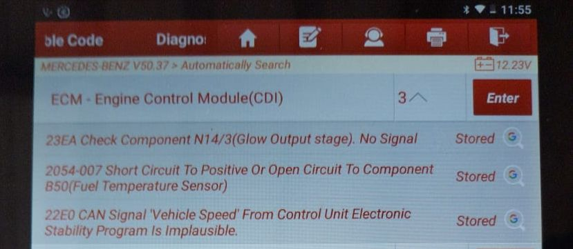

I OWN A MERCEDES E220 CDI ELEGANCE 2009, DIESEL.
I HAVE BEEN NOTICING THE ISSUE OF CHECK ENGINE LIGHT COMING ON INTERMITTENTLY.
THERE ARE TIMES WHEN IT COMES ON LISTING THOSE-
1. If my fuel level falls below the half level
2. If I park my car in sunlight switch it off and then switch it back on again the light comes ( It does not come on when its running)
3. If I park my car at an incline.
When I open my fuel cap with the car running keep it that way for a few minutes it the Check Engine Light Disappears.
I have scanned it using the OBD Scanner and I will attach that photo here.
I would appreciate the help
