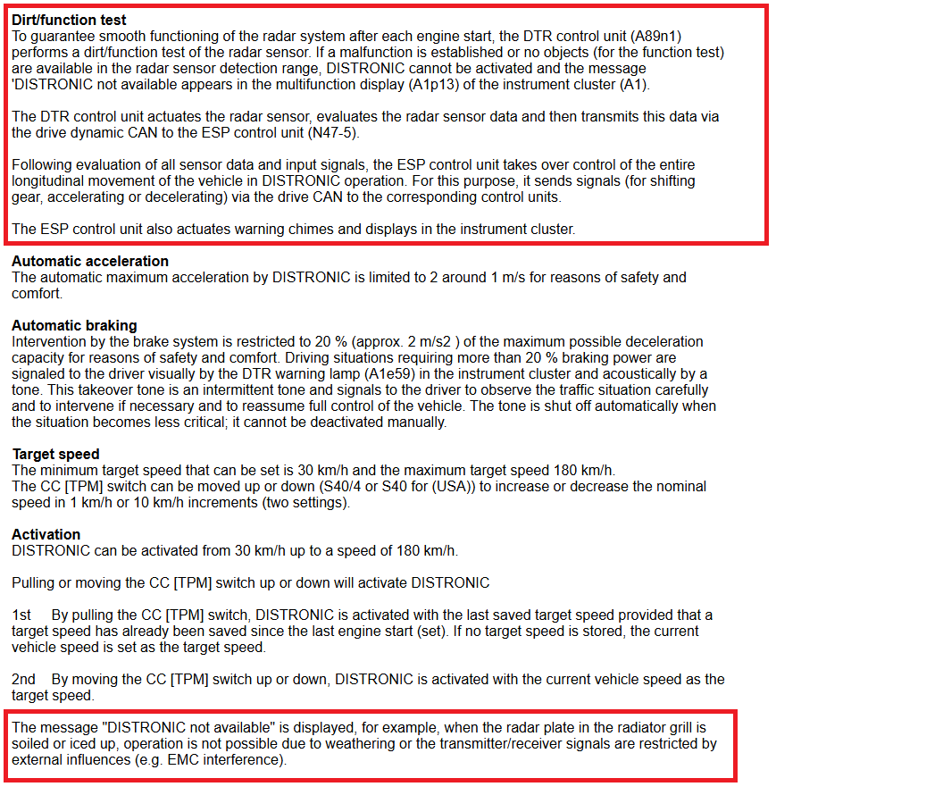

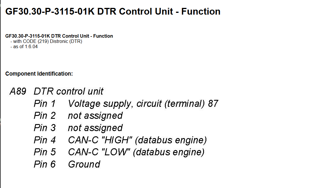

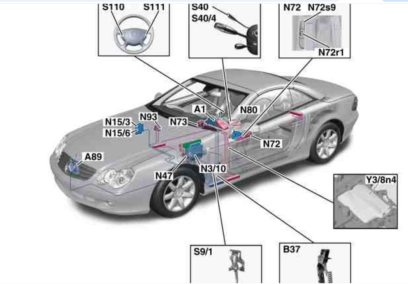

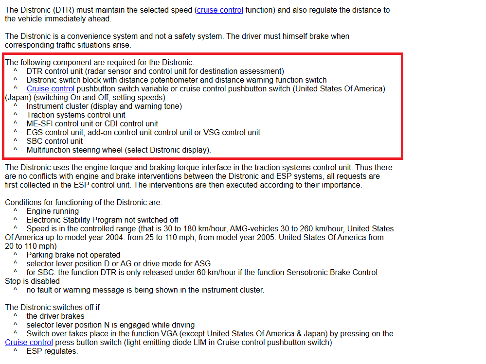

Are there any fault codes? I mean any, not just codes you dont think may be related to the issue.
There are a few components involved when using distronic.
Not sure what model year you have. Can always get out the multimeter and test the connections shown below.
