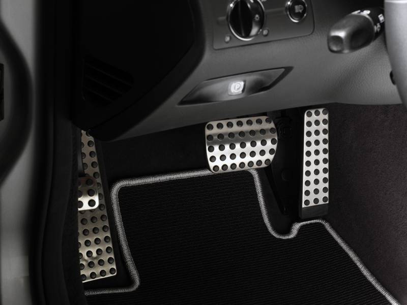

I need to get the part # for the Sport Package Footrest Pedal.

I would like the part # for all four of those pedals.

Part numbers for the gas, brake and parking brake are as follows:
A1703000004
A1702900182
A2304300084
Numbers may sound odd but the part numbers are the same for many models. I have them fitted to my 03 w211, they fit just like the original pedal rubbers in that you just slide them onto the metal pedal. Gas pedal requires the removal of a bolt to free the pedal and slide the old rubber off.
Havent got the foot rest number but if anyone does please post it.

First of all... why do any of you need the part numbers? Can't you just go to the dealership (where you will probably order them, right) and tell them you want the pedals for a sport package car (option code 952)?
When you ask for part numbers, you get into problems like people supplying you with incorrect numbers or the dealer telling you that "that part number is no good."
As an example, if you order part number A230 430 00 84 (listed earlier in this thread), you will definitely not get the parking brake pedal cover shown in the picture. You'll get one for an R230 SL, which has OVAL rubber nubs instead of round ones. That won't match. (I think this has been discussed to death in the past, but oh well, what's a few more posts on it to confuse people who actually DO search.)
If you do have a problem with your dealership finding part numbers, then have them look for the pedals for a W203 sedan instead (like a C230K sports sedan with option code 949/950). Same stuff.
Then, if you get the wrong parts, it's the dealership's fault, not yours.
