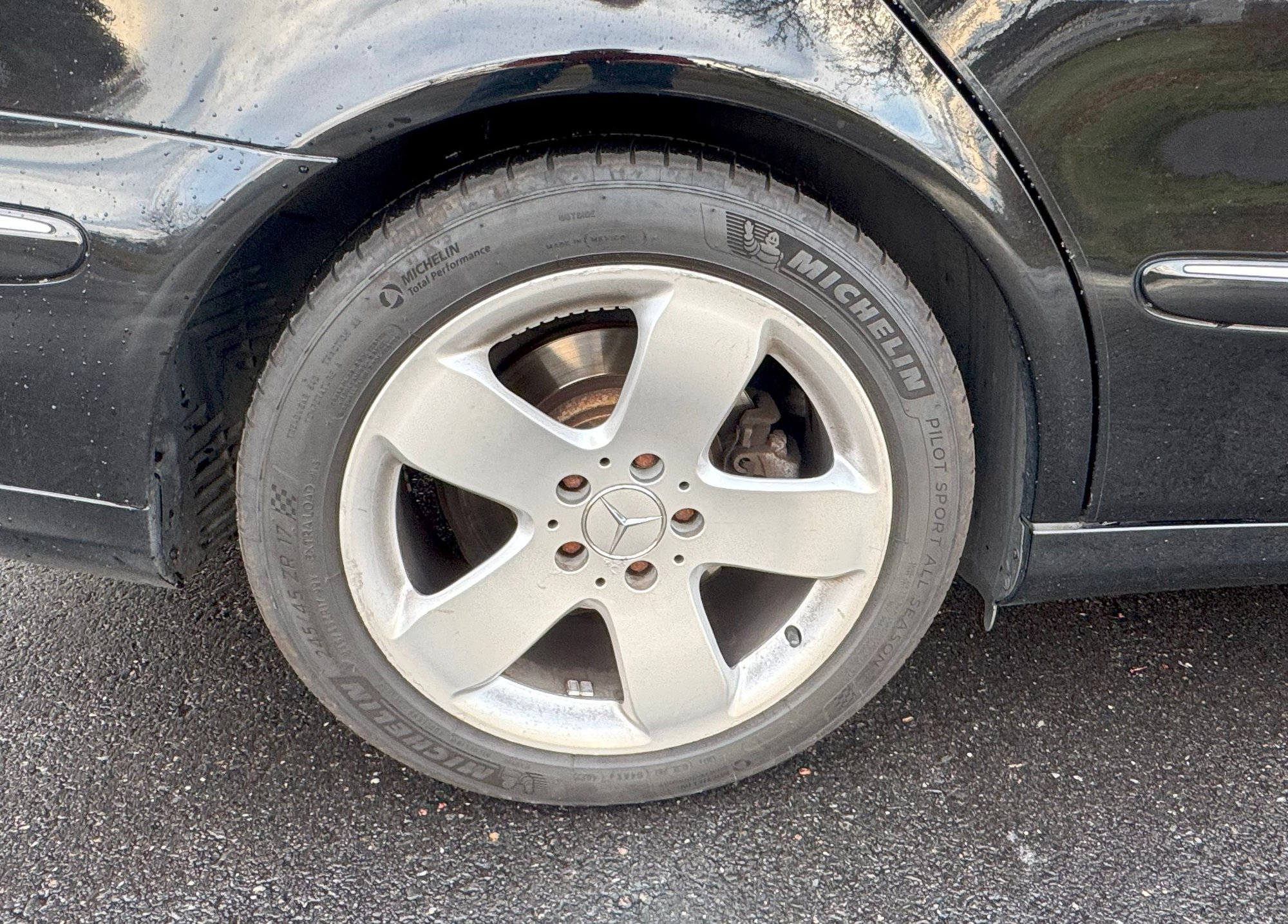

2005 SL500 rims in question will require new tires as ones in picture have dry rot...tires on 2006 E500 4Matic are fitted as shown in picture.
If they will swap I will migrate them, otherwise will plan on new tires as well.
Ths!!
Will these rims fit/clear lock-to-lock w/ no rubbing on 2006 E500 4Matic?
Current rims and tires as fitted on 2006 E500 4Matic.
