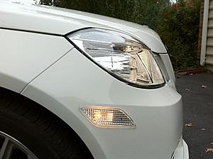

I just replaced my orange side markers with Clear ones I got off eBay.
Drastic improvement IMO...
I would recommend using the bulbs that originally came with the car (do not switch them out with the new bulbs that come with the clear markers). The bulbs the vendor provides have an orange hue. If you stay with the original bulbs they look great (clear and bright...no orange). Follow the previously posted instructions from "doctordel"...pretty easy. When you pop the lens out, just be carefull to realign the backing plastic plate to reattach the new lens. Pretty self explanatory once you do it...but it is the most difficult part of the job because you have to do it kind of blind. Good luck.

another member mentioned those too, and it got me thinking as well that I didn't think they were cool..........and now they really stand out to me when I see the car........
yours look really good from your pix
