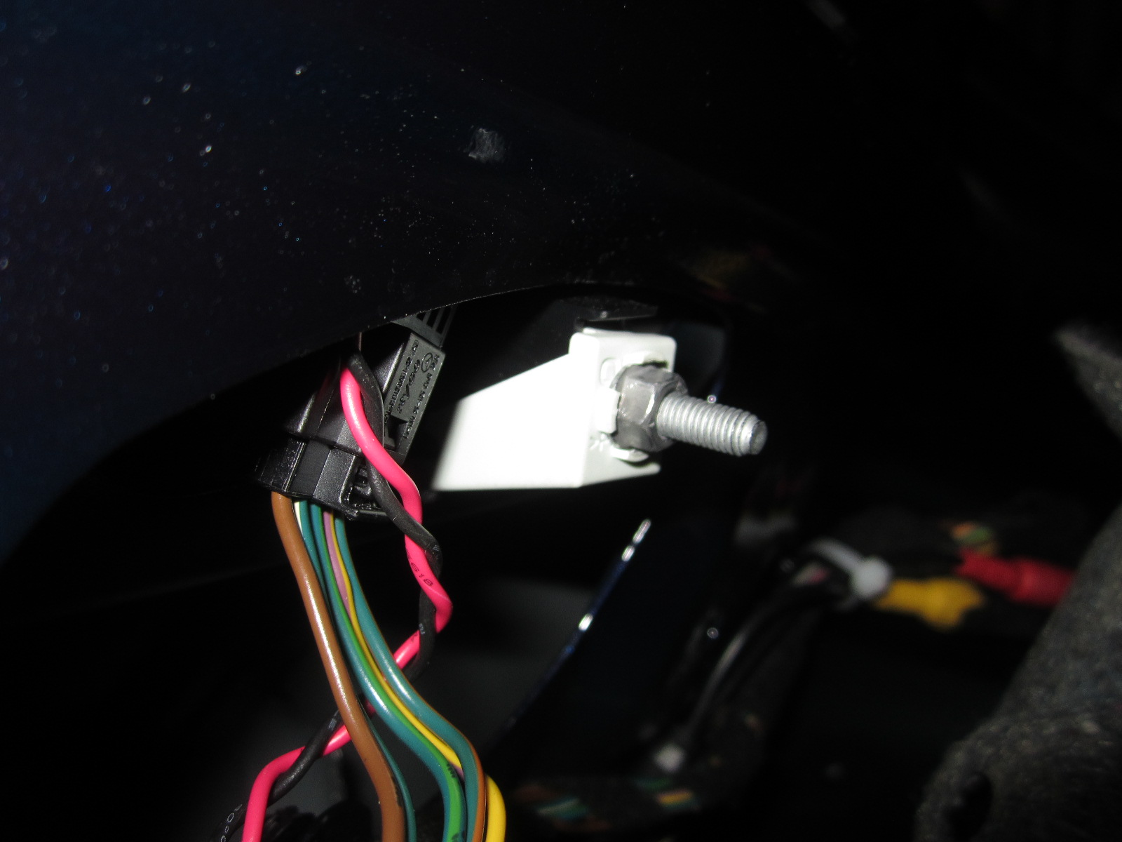

You are not looking in the right spot, you will need to remove the grey "cloth trunk cover" and will need to unscrew one bolt which will release the reverse light housing and allow you to access the light bulb. i will have some pix later but i have not had any luck with finding the right LED's (gone throught 2 sets) despite buying error free canbus led's, message is still coming up on the dashboard.
anybody have a link to bright reverse LED that will work for sure? i was looking for some that have a Projector at the end?

added the pictures. it is pretty easy but certainly more work than one would want for changing a bulb.
