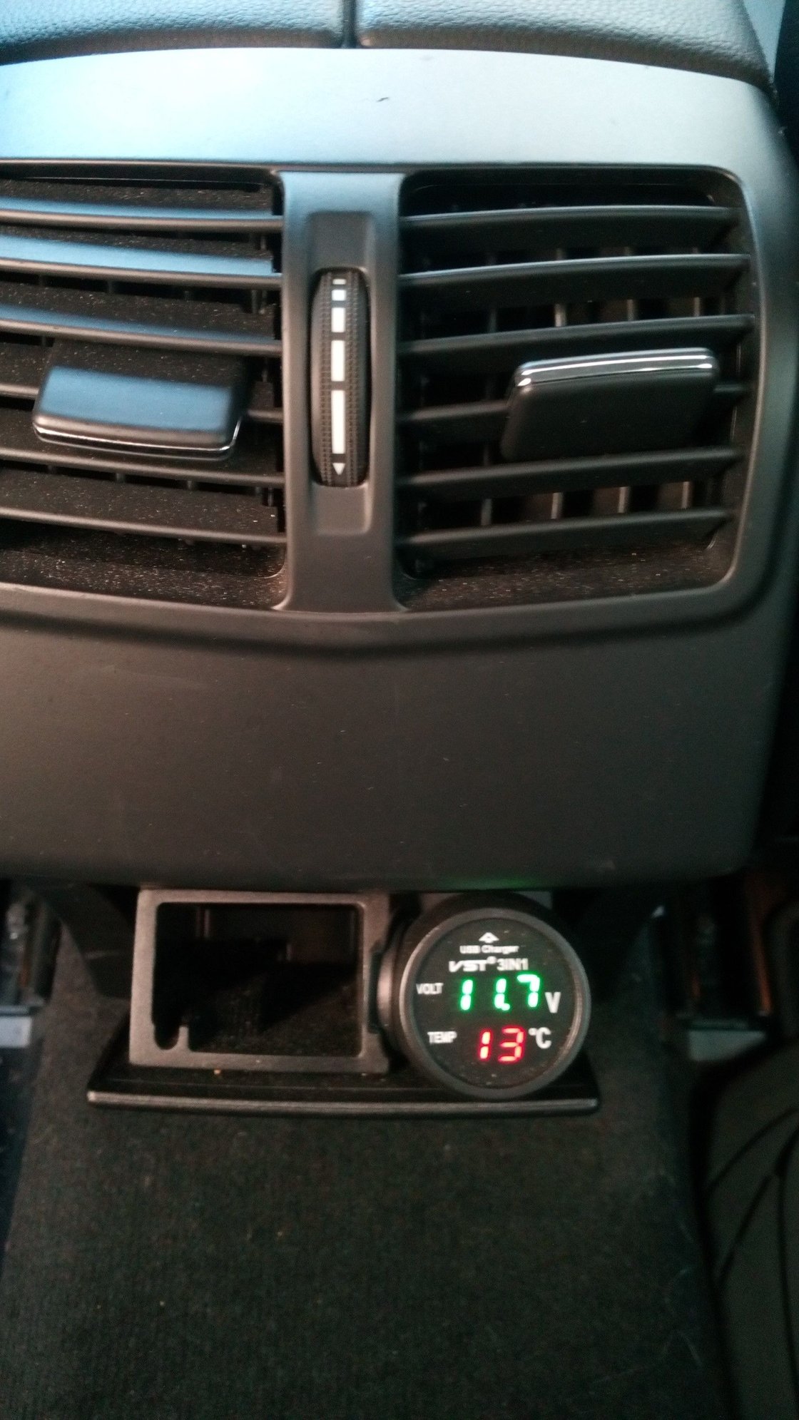

4 Posts#20 1 h ago (Edited) I have now installed a voltmeter in the cigarette lighter socket to be able to control the instantaneous values.
I can now confirm that when the engine is idling, when braking or decelerating the vehicle the voltmeter indicates 14.8 volts. On the other hand, in acceleration of the vehicle the value immediately goes to 12.6 volts.
If you don't go on winding roads, your battery will probably have a compromised life expectancy and some morning, sooner than you think, you won't be able to start the engine!
As soon as you stop the engine the battery voltage starts to drop immediately. It seems that for about 20 minutes the systems of some electrical equipment remain in charge, therefore contributing to the discharge of the battery which, in case of deficit, is in danger of collapsing
I am considering replacing all the incandescent bulbs in the interior with LEDs to to decrease at least that energy consumption but as my MB agent told me that there have been problems with this that caused errors in the car I would like you to tell me if you have had any experience in this matter.
Spoiler
Idling, braking or slowing.
Stopped with a low charge battery.

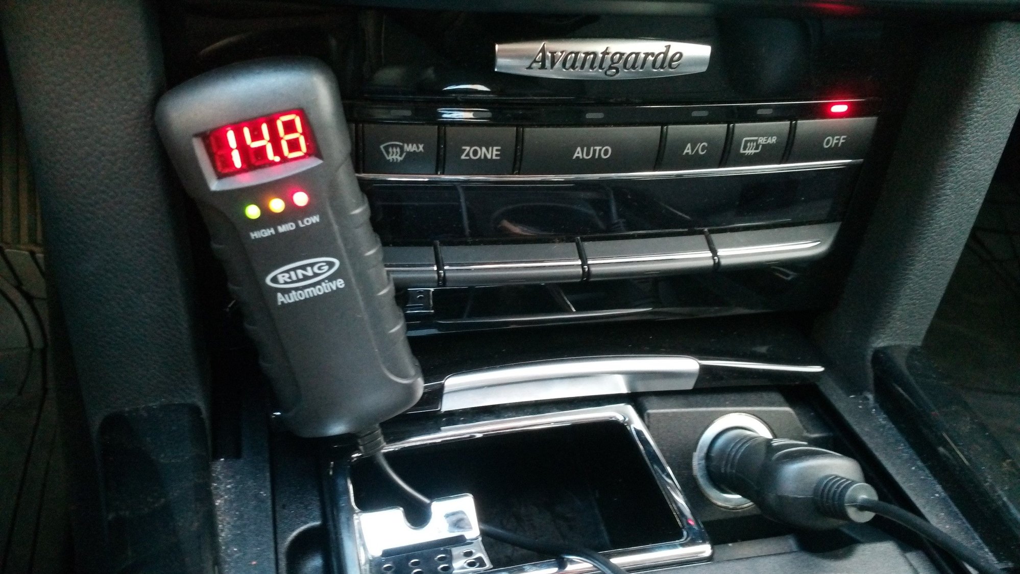

I can now confirm that when the engine is idling, when braking or decelerating the vehicle the voltmeter indicates 14.8 volts. On the other hand, in acceleration of the vehicle the value immediately goes to 12.6 volts. If you don't go on winding roads, your battery will probably have a compromised life expectancy and some morning, sooner than you think, you won't be able to start the engine!
I am considering replacing all the incandescent bulbs in the interior with LEDs to at least reduce this energy consumption but as my agent MB told me that there were problems with this that caused errors in the car I would like to be told if they have had any experience in this matter.
Greetings to all.
As soon as you stop the engine the battery voltage starts to drop immediately. It seems that for about 20 minutes the systems of some electrical equipment remain in charge, therefore contributing to the discharge of the battery which, in case of deficit, is in danger of collapsing.
Greetings.
Sttoped with a low charge battery.

Carlos,
In your picture you have that beautiful Avantgarde badge in your center console. Did your car come with it?
My car is also Avantgarde but it does not have that badge. I wonder if MB just left it out of U.S. cars...?
Would like to buy one from somewhere...

Hy Arrie.
Yes.
My 2011 W212 E250 CDI Bluefficiency Estate Avantgarde already came with that badge.
You can try to check out on your M.B. local dealer as I'm shore they'll have it.
But the price will be probably high.
Before you buy on M.B.dealer you could also try Chinese online shopping sites they have almost everything and are sometimes interesting products with reasonable quality and very cool prices.
Greetings.
