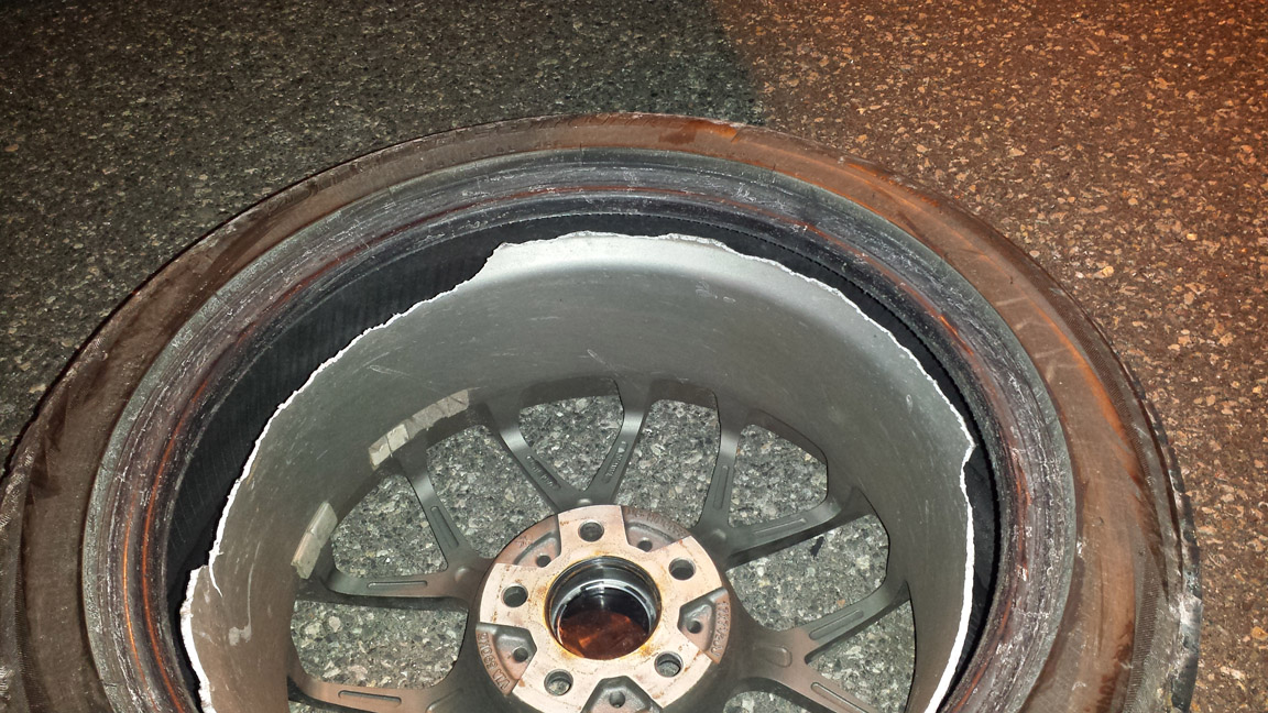

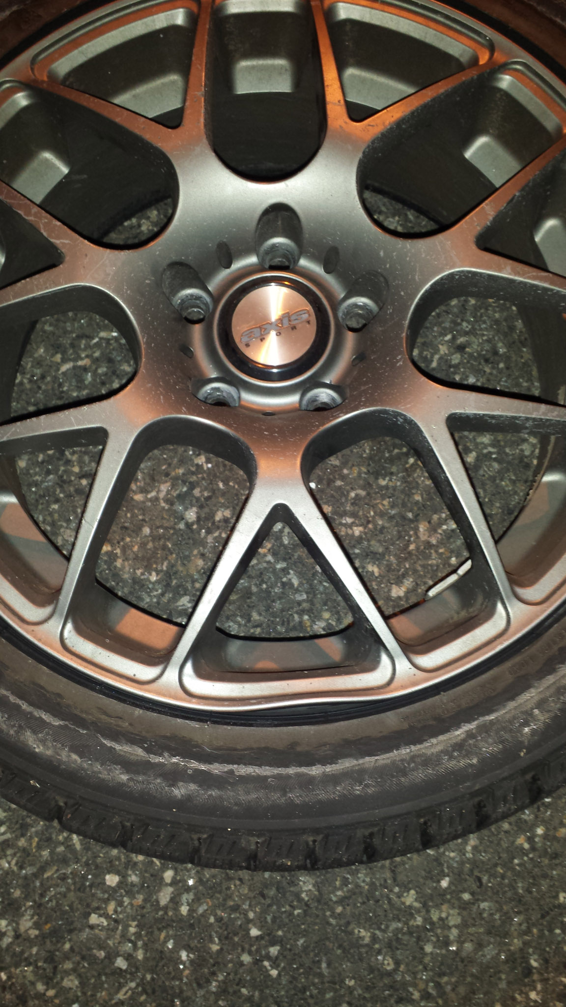

After I had a tire rack wheel literally disintegrate after hitting a NYC pot hole, I would not buy anything but OEM wheels from the dealer.
These wheels were inexpensive, and they were cheap too.
Axis declined to do anything for me at all, until I posted these pictures on their facebook page, in a post titled Axis vs Pothole: guess who won and guess who lost.
Within 15 minutes, they had found me a new wheel.

wow! that could easily kill someone.

Holy crap! I would have never thought that a rim would shatter like that.

Generally speaking....A forged wheel (like a factory Porsche Fuchs wheel) would not do this. Forging means a single piece of aluminum is smashed into shape by huge presses. Most after-markets are cast wheels, where molten aluminum is poured into a mold, hence they are usually weaker and heavier.
http://www.tirerack.com/wheels/tech/....jsp?techid=90
