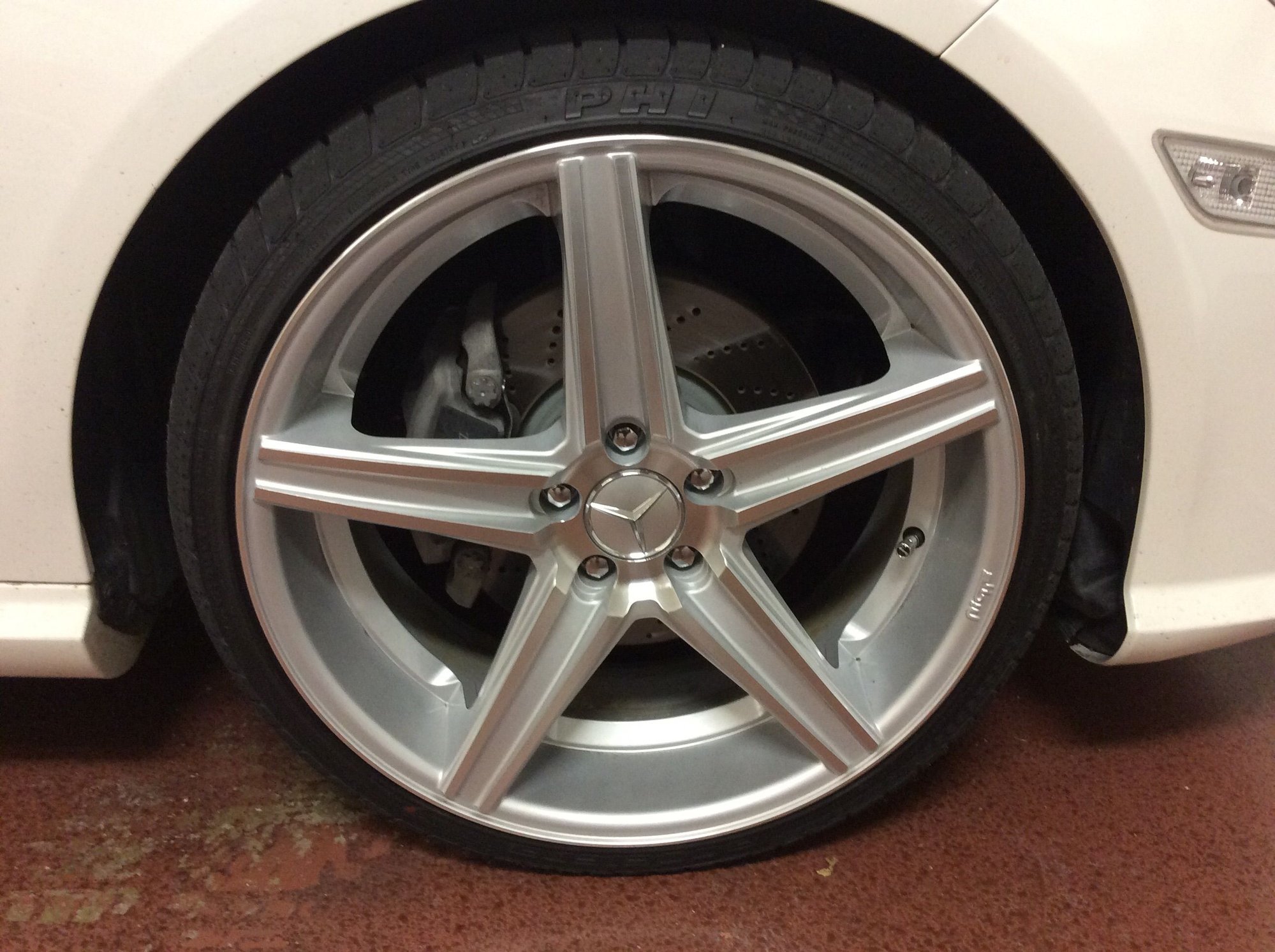

I'm currently running 20" wheels (pictured) but the rubber band size tire is making me feel way uncomfortable.....I've already bent the rim once and it's only been 5 months with them mounted.
18 inch wheels hardly have the options in style, compared to say 19" or 20"....and they of course look better.....everything I've read says to run a 35 series tire. With a 19", which is a little "thicker" but I'm gunshy. Just might not have the nuts anymore, cruising down the street feeling like my wheels could get bent at any moment.
Current front wheel setup, 245/30:
