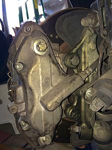

While replacing the Front Brake rotors, I am running into the problem that the 2 18mm bolts on both the left and front wheels are so tight that I could not manage to open them.
I put WD40 on the bolts but after 30 mins they still wouldn't budge.
Any ideas?

I think Mercedes use Loctite on these bolts. You need to use a hammer. I've had same problem when i was changing front rotors on my 2010 E550
Good luck.

Those are a real bear!! I feel your pain. I was all set to use my impact driver but, did not have a 18mm 1/2" drive?!?!? WTF!!
Anyways... I turned the wheel for better access and got a longer breaker bar on them and they finally loosened up. I did have a few sore muscles after and I do own the approiate impact socket now.

I use PB Blaster (rust blaster) instead of wd40. I have better luck with it on breaking bolts loose.

Use a little heat on the head of the bolt, let it set a minute for the heat to penetrate and should have no problems. just don't touch it bare handed while disassembling.

Just did my brakes, when i worked on the right side i turned the wheel to the left for better access and used the extension for more leverage. BTW my rears were pain in the neck rotors didn't want to come off. make sure when you put new ones on put some antysease for next time

Turn the wheels with caliper out and use a long breaker, like 2ft long. That will bust loose pretty much anything with ease.
