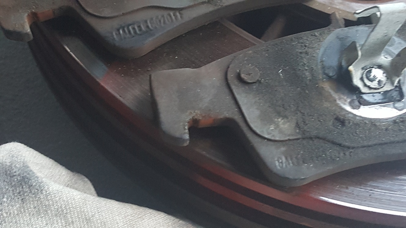

how often you change your rear pads?
i bought the car with 32k miles on it and never changed rear pads(still in a good shape too) , and im at 92xxx miles now
front ones i did change like 2 times already. i understand that front ones wear out faster due to load , but rear ones.... maybe im just overthinking but still , better to know for sure. thanks.

I changed mine at 99k. As mentioned in another thread, the outside pads look like yours does, but the one most worn down was the inboard pad on the right with the sensor. Got it used so I don't know if they were changed before, but the old pads were OEM MB pads. I used Akebono, hopefully the brake dust won't be bad.

oh so its better to check the side with sensor (passenger rear) and the inner pad not the outter one ?
i heard good things about akebono , im pretty sure itll be like 99% dust free or even dust free at all

Yeah, the inner one wore more than the outer one, but just by a little bit. Also the light goes off when there's still appears to be plenty of pad left. I guess if you do them early you can reuse the sensor. I got the check brake pads message every time I started the car so it was a little annoying having to clear it every time.

oh aite , ill check the inner one. and i dont really care bout sensors.. i have like 2 laying around. thanks for your help

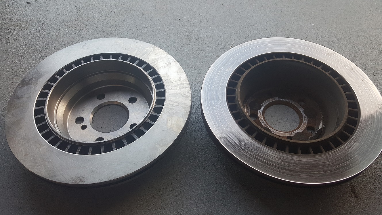

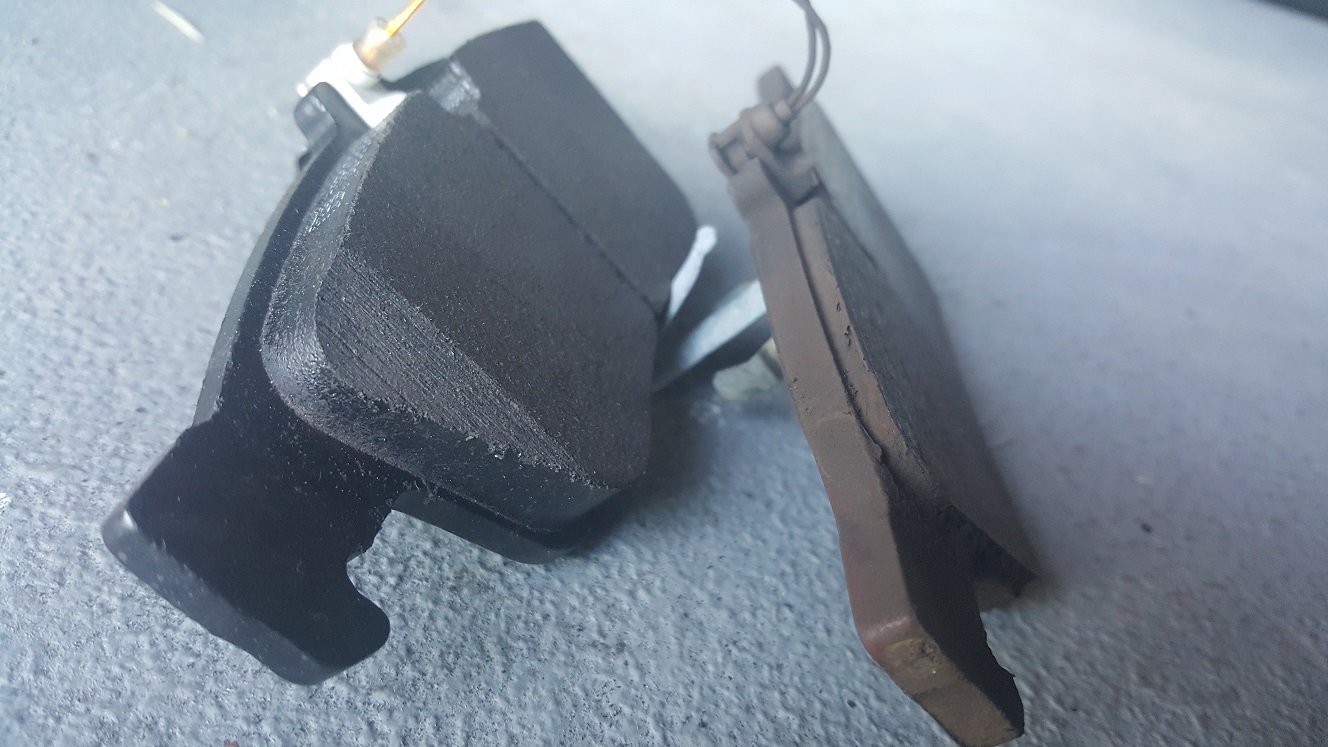

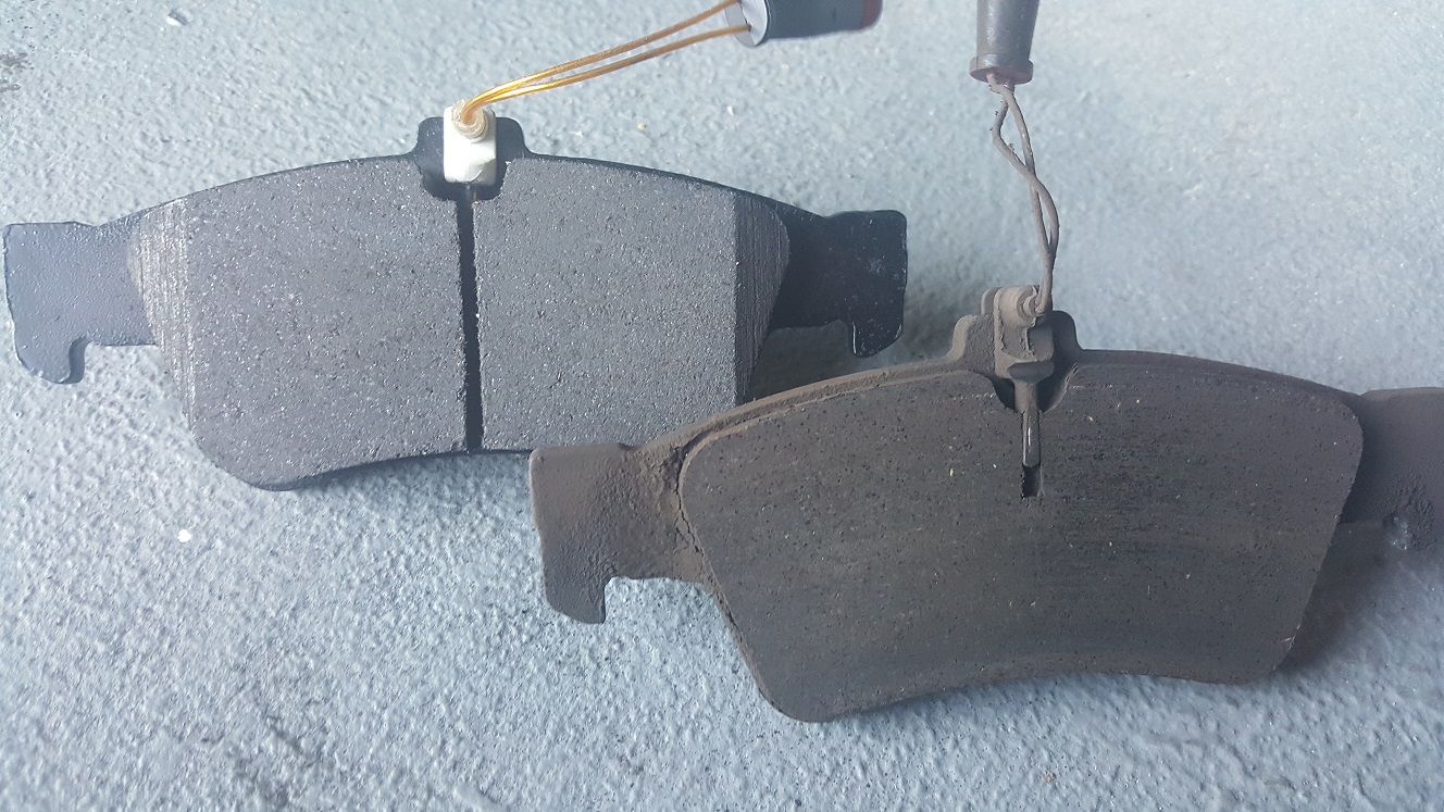

so finally got all my parts today , so decided to install them.
old thread , but didnt want to start a new one just cuz of this.
everything went well , pretty easy.
got centric rotors and centric super premium ceramic pads.
ill just leave it here..
one question though , anyone heard of GALFER brake pads? (see pic) they were pretty good actually zero dust almost , googled and couldnt find much. looks like was installed when came from factory
