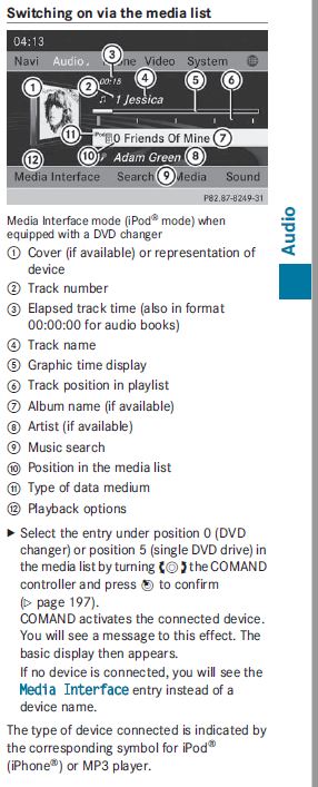

Try this...

Dan, Thank You for the speedy response. I have been going into settings in audio and when I try to select media interface the command screen says no device connected I'm beginning to wonder if I do indeed have a bad cable, as I also tried to hook up my iPhone 5S with Media Interface cable.
