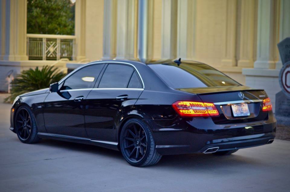

I just bought mine about 6 weeks ago. 2011 with 70k miles. I specifically went out looking for a e350 bluetec. I was not aware of the oil cooler issue and after a few days of having it, I noticed puddles of oil in my garage. So now I am currently dealing with that issue. Luckily my friend is a MB mechanic and he is doing the Seal job for me. Other than that and replacing the battery. I love it! Even installed lowering springes and some wheels for a nice look!
