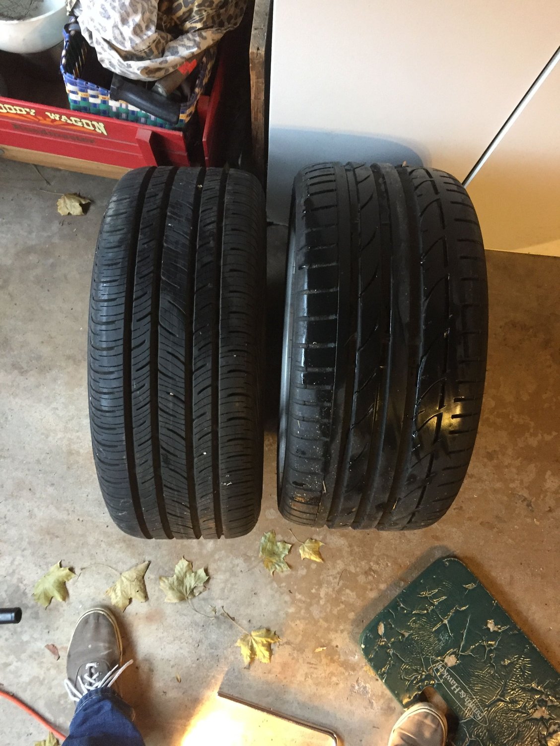

My E63 AMG wheels are those exact specs 37ET and 52ET -9x19 and 9.5x19.
This is what it looks like with a non-lowered suspension. The front is good and the rear could use a slight 5-10mm spacer.
245/35 in front and 285/30 in rear. I included a side-by-side of the 285/30-19 tire vs stock 245/45-18
