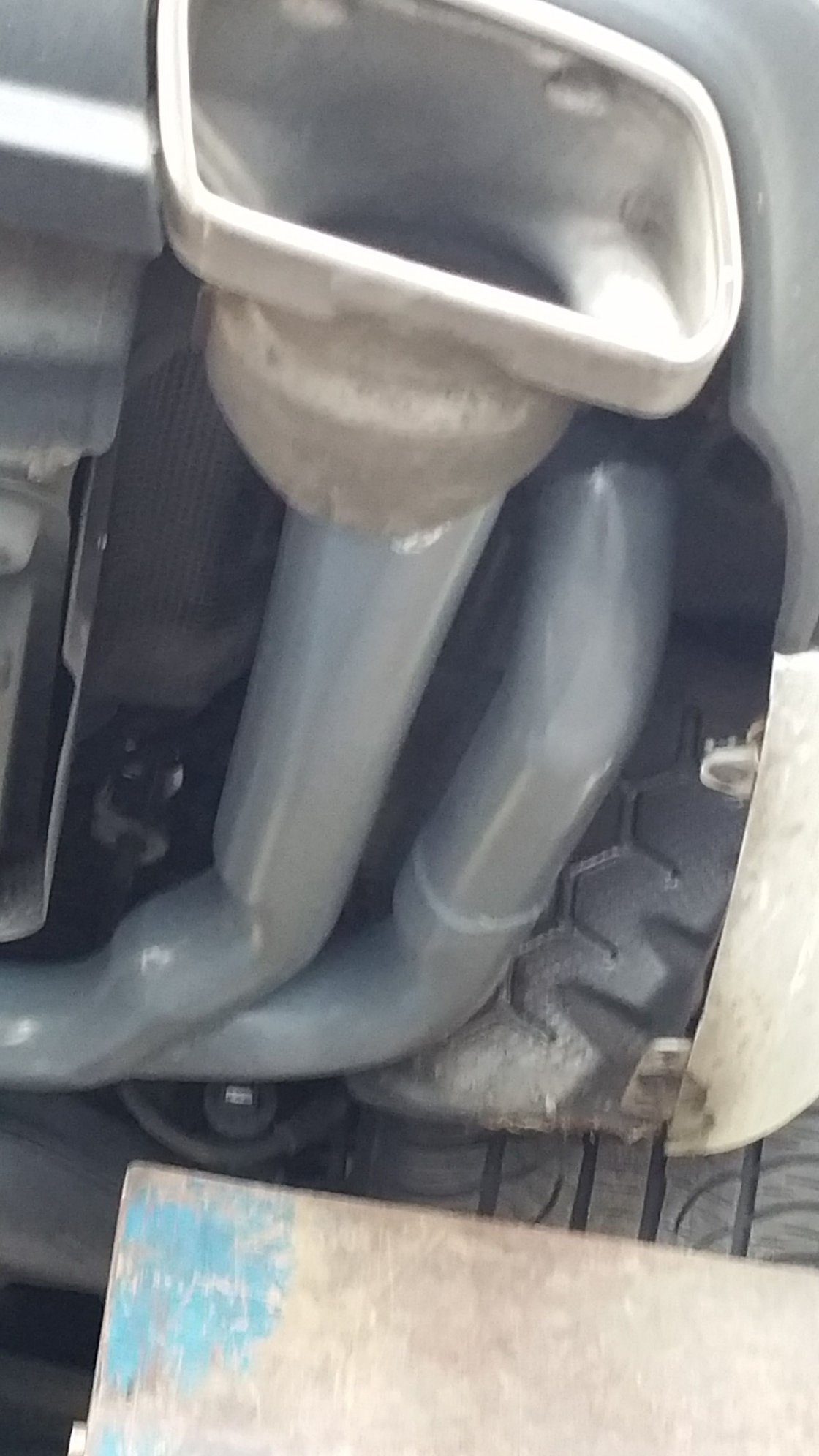

Nice! I hate to ask but any chance you can send us a picture of the underneath of your car to see the pipe configuration?
When I went in to book my appointment the mechanic showed me the pipe he was going to use and it had an elbow but not sure if that is a J-pipe though
Old Apr 18, 2018 | 06:04 PM
The Truth's Avatar
Joined: Dec 2016
Posts: 211
Likes: 84
2015 S63 & 2014 ML350
Old Apr 18, 2018 | 06:07 PM
nsb_88's Avatar
Joined: Apr 2018
Posts: 35
From: Edmonton
W212 E550 4Matic
Cheers mate!
Am I right in saying that the pipe to the right is capped and the left side is the one which leads to the tip?
Old Apr 18, 2018 | 06:13 PM
The Truth's Avatar
Joined: Dec 2016
Posts: 211
Likes: 84
Originally Posted by nsb_88
Cheers mate!
Yes sir!
Old Apr 18, 2018 | 06:18 PM
nsb_88's Avatar
Joined: Apr 2018
Posts: 35
From: Edmonton
W212 E550 4Matic
Interesting! This is the first time I have ever seen such a set up. What is the main advantage of installing a J-pipe as opposed to just straight? Im guessing it is not as loud and eliminate drone?
