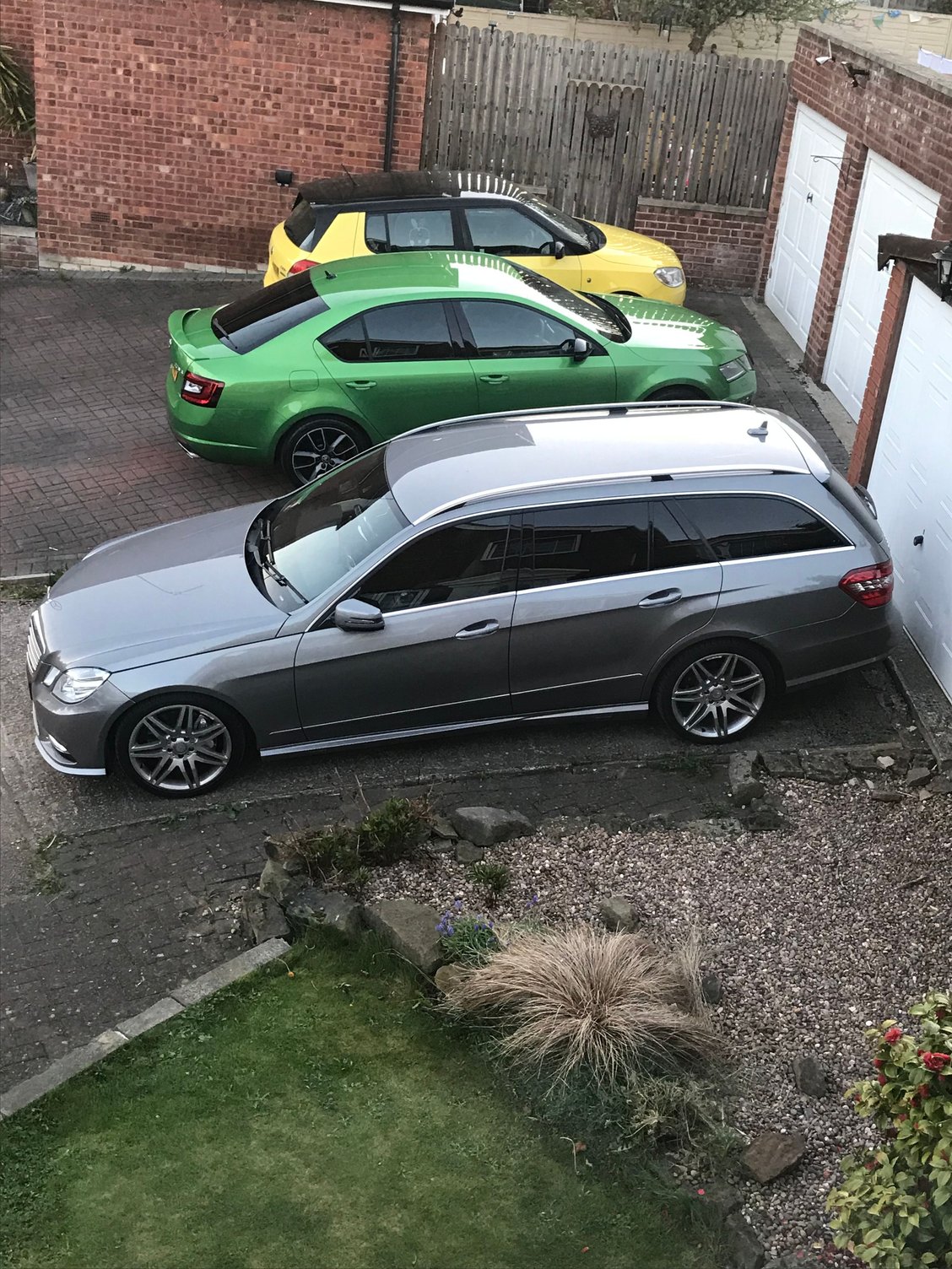

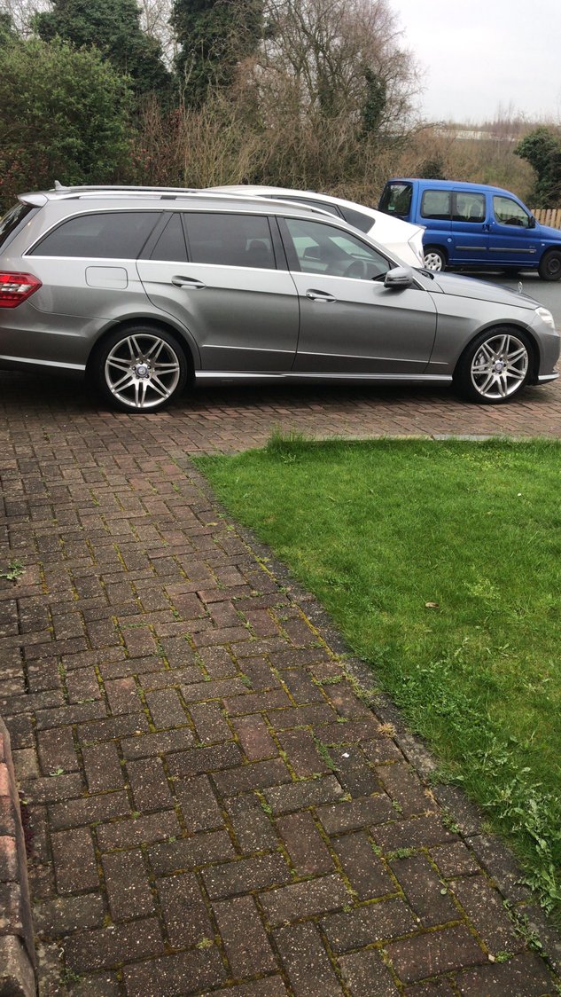

Hi everyone.
Just purchased this E350.
In love with the car!
So..i’m curious to see if you guys know any of the common issues they have so i can get them sorted out ASAP.
The car had 64,000m
to me the gearbox seems a little bit jerky, and not very smooth like i had hoped? Thinking about a oil and filter change of the AT?
have a good day everyone

Welcome to the forum! That's a very nice looking wagon/estate.
