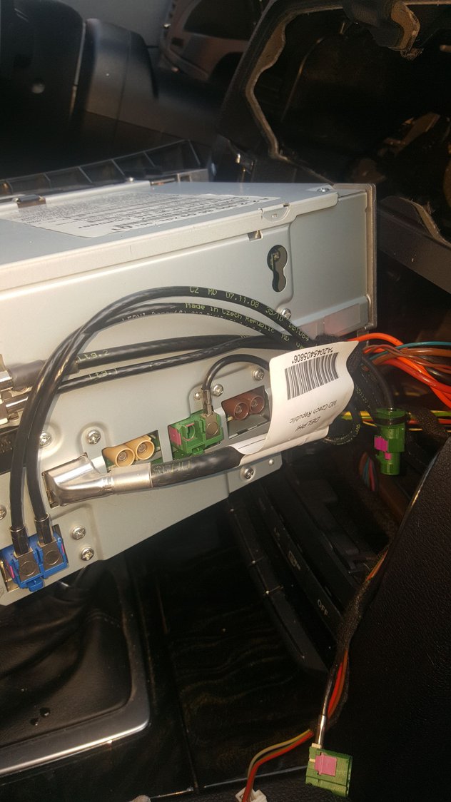

.So I am installing a reverse camera as my 2011 e550 coupe did not include one. Does anyone know which socket I am supposed to plug the new camera into? I tried the double green but dont seem to be getting anything. Any help wou;d be greatly appreciated.

I did a DIY rear camera install on my 2011 E350 W212, no parking sensors though.
Here is a picture with my head unit pulled out. If I recall, my green connector plug-in fit on the right side of my HU when removed like this. It looks like something is already plugged there on yours currently. Maybe a dumb question, but have you tried the green plug in on both sides for results?
I know mine was a PITA to fit in, but once it was in all was good. I also followed the instructions on other threads to activate the backup camera in the engineering mode and worked like a charm.
