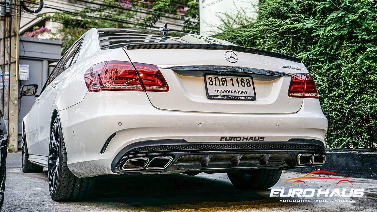

expected look after conversion

Im owning W212 2009 E Class 250 CDI and i want it to upgrade to the new facelifted look
Conversion on car will start in 2 weeks aprox.
My first steep will be adding second exhaust for body kit to apply normally.
The rest of process will be carried out by professional car repair shop best in my area.
Things that trouble me:
-My front bumper has xenon headlight wash, the new one facelifted bumper dose not have slot for it, can washer be disabled and remowed properly? (i wont miss it)
-Conversion kit comes with front and tail lights, as you know they are not OEM MB (original), will i be missing some functions regarding front headlights and degraded quality in comparison to original facelift headlights (will i lose turning lights function, will errors pop up on car computer....)
-Just of curiosity, Can i fit original facelifted headlights into preface lifted model of car in software speaking manner, (i googled original headlights A2128205539 and A2128205639)
-Will conversion complete with error free on car computer?
