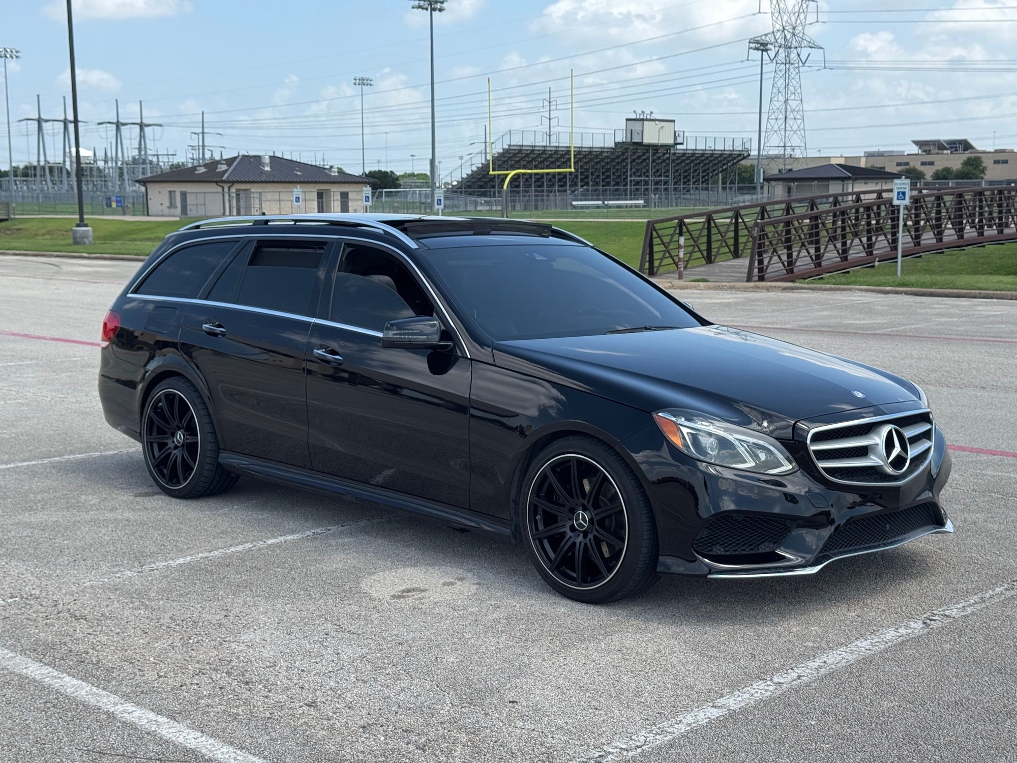

I run 19s on my E-wagon

2014 E350 RWD riding on 19 inch AMG rims off of a W213 RWD. No fitment issues. No rubbing. Ride quality felt similar to what it was like on the 18" wheels.
245/40ZR19
275/35ZR19
