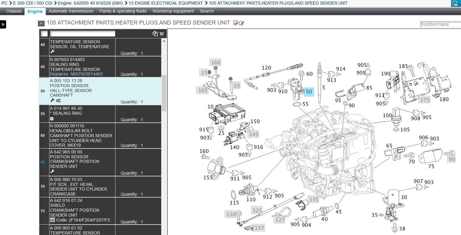

Hi Folks,
I have a w212 E350 CDI 2010, the car takes a while starting and yesterday EML light came on while driving. Stopped and three engine restart switched the light off. Came on again while driving and got it connected up to a computer. The error
No Signal from Component B6/1 (Camshaft Hall Sensor)
Does this mean the camshaft sensor is faulty and if so has anyone a diagram of the position under the bonnet. I have searched google every model except my own and surely meant to going on holidays Thur and cant get a mechanic to sort so a diagram where to find would be so appreciated as I will do it myself if not to hard to find I know there is just a electric cable and a bolt to remove.
File Type: pdf
