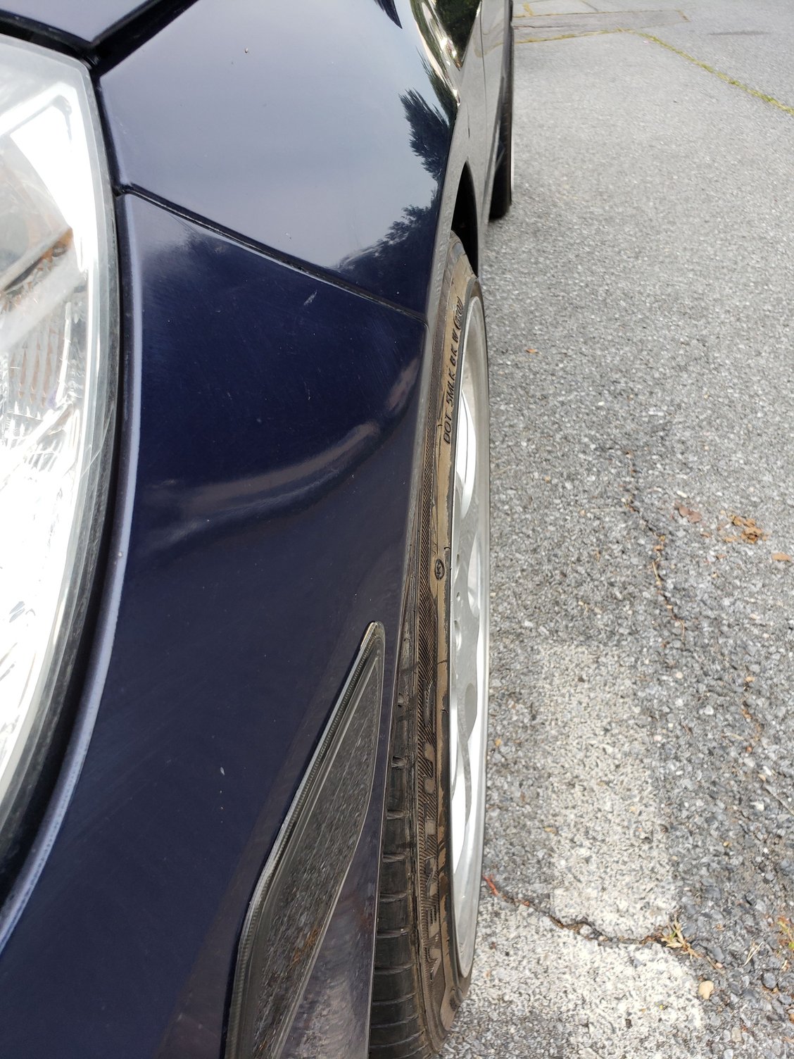

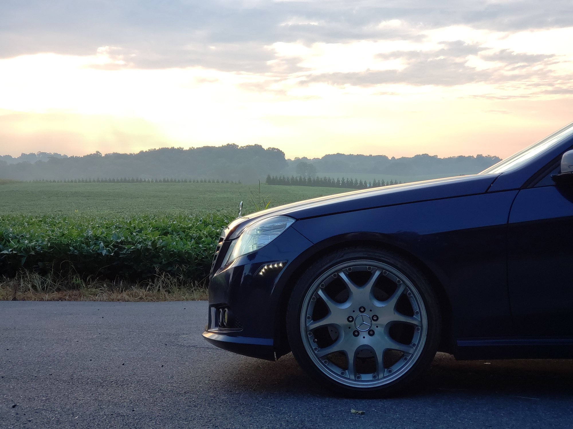

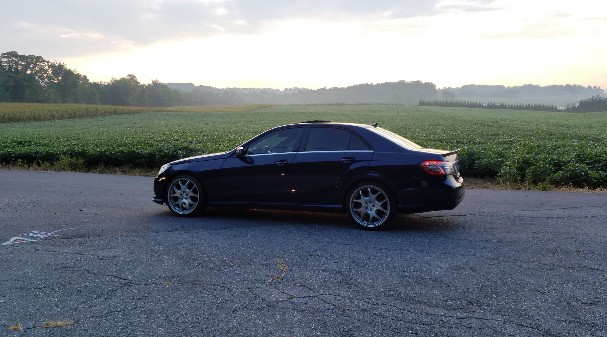

Recently upgraded my wheels when the time came to replace the original 18 inch tires, picked up a set of brabus monoblock v's. No spacers, but I did get hubcentric rings and longer studs with conical type seat.
The wheels are 20 inch by 9.5 all around, with offset being 37 The tires are 245/35/20 all around. There's a bit of tire rub over bumps but not bad, the car accelerates a bit slower but the ride quality isn't effected in my opinion.
There's a very slight poke on the rear fender maybe 5mm or so
The front also has about 5mm poke from fender

Your tires look really stretched. Not a fan of that.

There's a bit of stretch, but if there wasn't it would permanently rub on the front struts while driving
