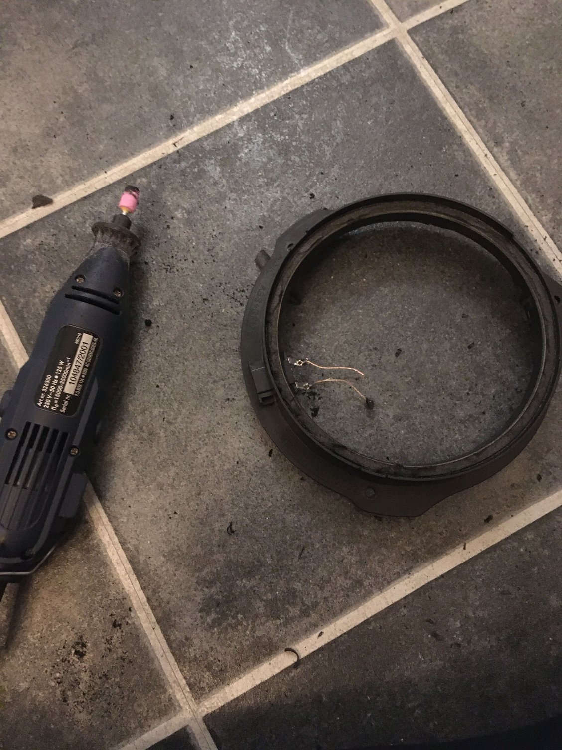

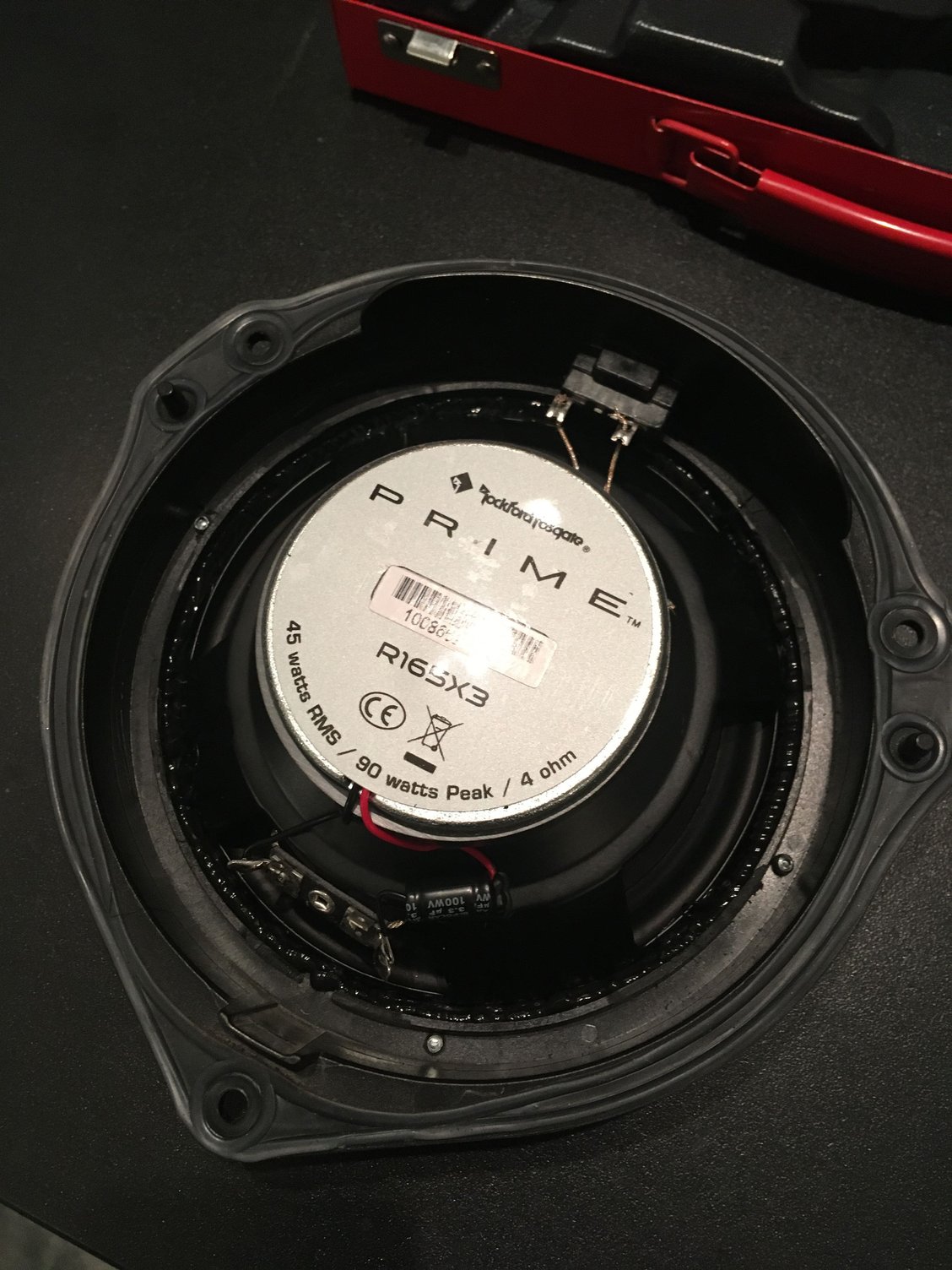

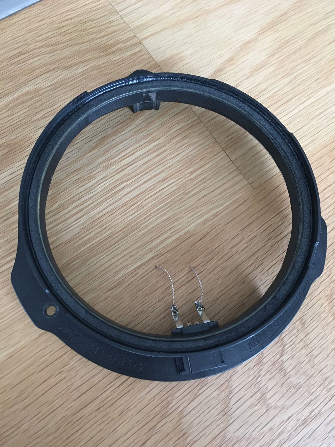

Measure out that’s this cone fit 6.5 speaker my local dealer had Rockford fosgate for good price 👍 Cut out old speaker and plastic. Now mod in new speaker to use it with original cone and cable. This going to hade original look. Video coming up later.

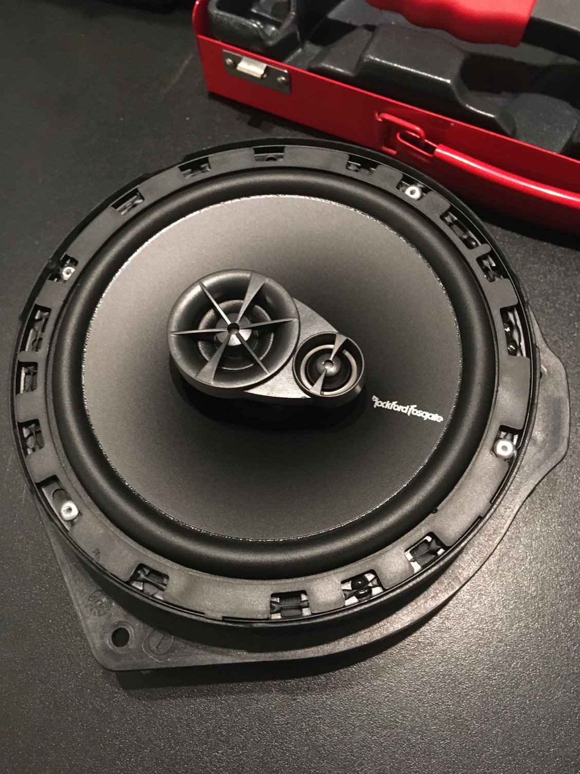

Look almost as stock : )

Have now try this new speakers for a few hours and the sounds it’s really good clear and nice. But when I think about that I miss bass sound little bit tweeter take it away. If your doing this you may go with speakers that not have tweeters if you like bass sound.
Not a sound guy but its play good!
